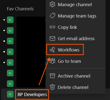

1. Pick a channel (not a group chat) within a Team, and right click on the Channel and go to 'Workflows'.

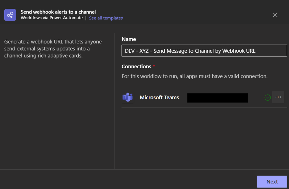

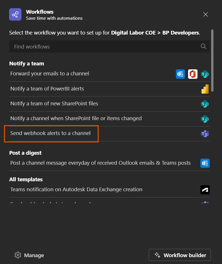

2. Go to 'Send webhook alerts to a channel'. Should already be in the list without searching but you could search for it instead if it doesn't show up by default in the future.

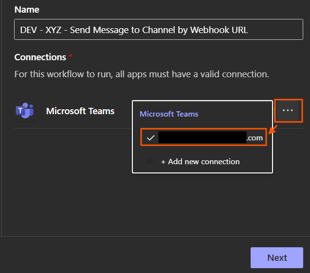

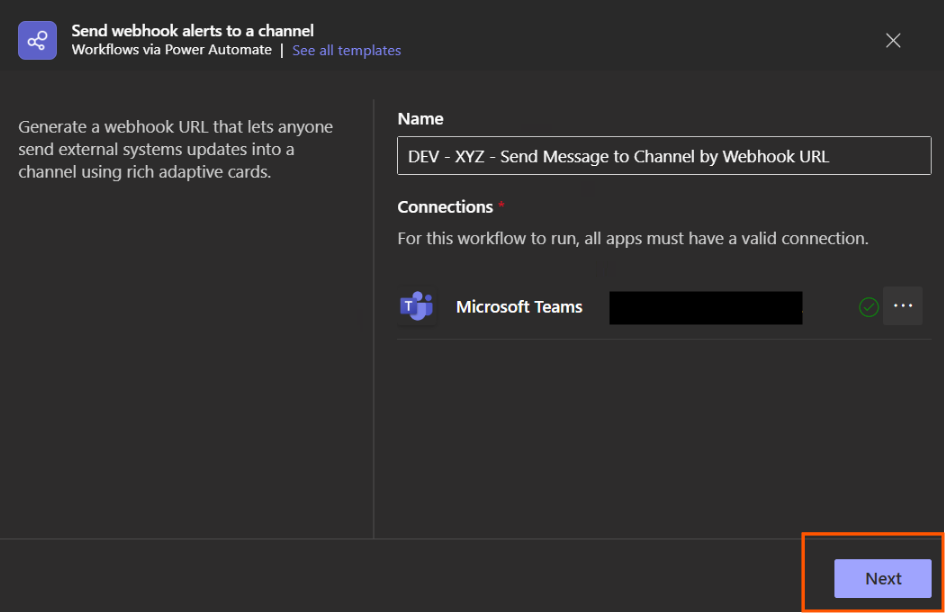

3. Give the workflow a good, clear name. I like to include the environment it is associated with, such as dev, uat, prod, etc. I also like to include the phrase 'by Webhook URL' at the end so I know based on the name of it what the trigger is. The reason this is helpful is that this will show up in your Power Automate flows when you look at cloud flows too so it could get rather confusing if you don't have a specific name.
4. Next check on and handle the connection in the same window as above. If it has a green checkmark, then you're good to go. If it doesn't, then you may need to do more to fix it. First try clicking whatever looks clickable. Microsoft changes this kind of thing now and then so in the future it may look different. One of the things is the three dots on the right. I don't have a good screenshot right now if what that looks like when it's not handled already.
Here's what it'll look like when clicking the three dots and the connection is resolved correctly. This screenshot is sanitized, but it shows my work email address, so it is actually going to be authenticated as me. You can also use a Service Account, but that takes more effort and isn't really worth it when you first are trying this out so I'd figure that part out later or never worry about it at all.

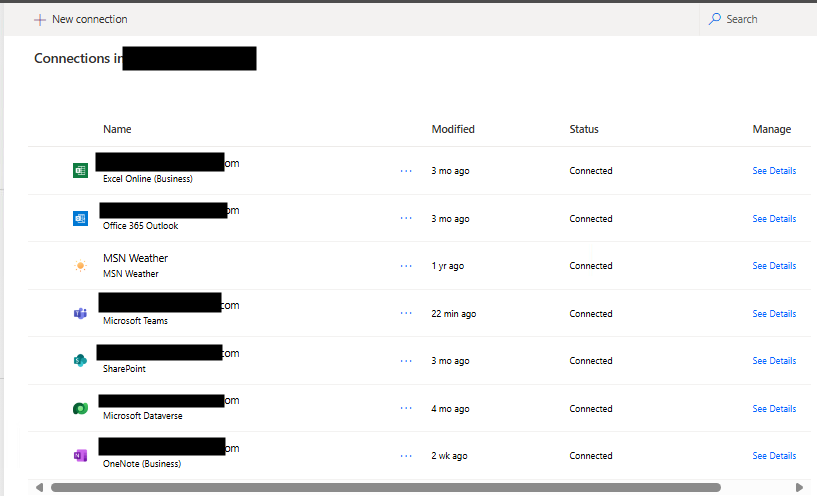

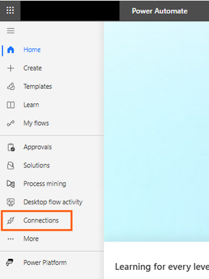

If you can't seem to resolve the connection in that screen, what you may need to do is go into Power Automate in the browser at https://make.powerautomate.com and go to Connections.
At this point in Connections, you should see a connection where the Status is something other than 'Connected'. Fix any that aren't working. Specifically we're looking for the one labeled Microsoft Teams of course. It should be as simple as clicking on whatever looks like they want you to click on it and then sign in which may require entering your password.

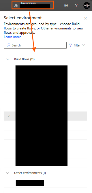

If for some reason you don't see a connection that needs fixing and Teams indicated there was something wrong with your connection when creating the flow, then you may be in the wrong Power Automate environment. Look at the top right of the webpage and click 'Environments' and look through each Environment you have access to in case the environment it brought you to isn't the general/default environment that Teams is connected to.
By now, I'll assume the connection has been resolved in Teams. Go back to check on it and verify it looks right and click 'Next'.

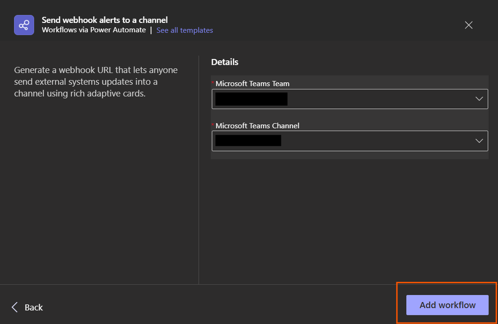

5. Now you have the opportunity (apparently) to change the Team and/or Channel that will be posted to. If you started by right clicking on the right Channel, then there's no need to change anything here. Click 'Add workflow'.

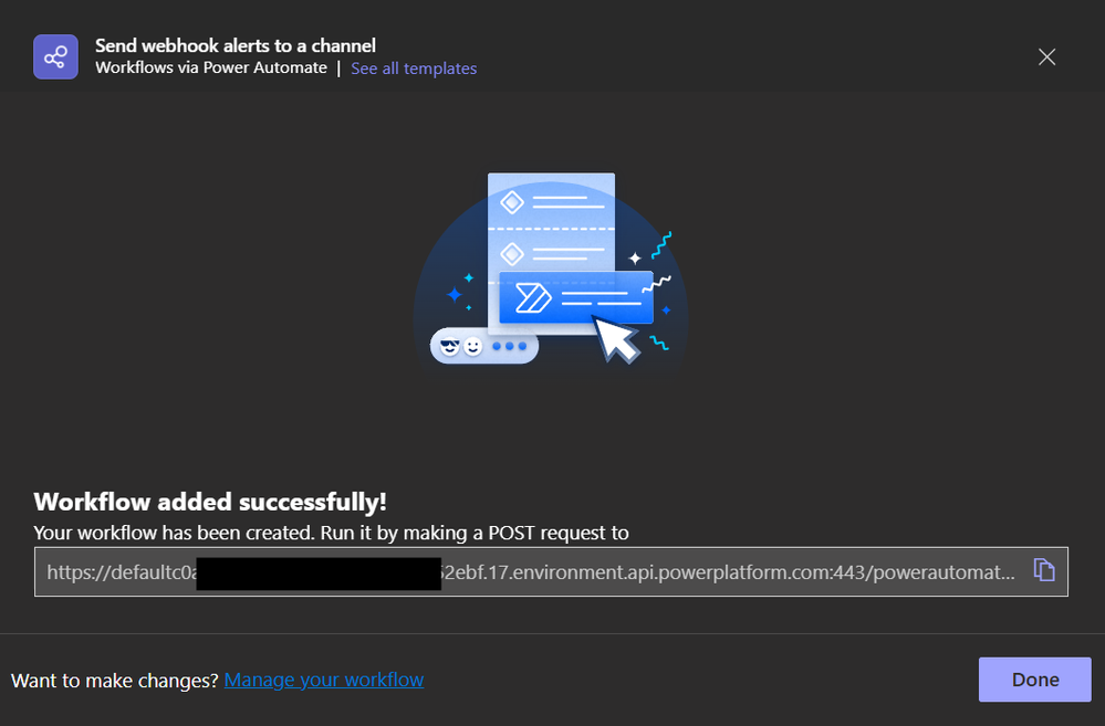

6. On the last screen, you're given the Webhook URL that you'll call/post to from in Blue Prism or wherever. Copy the URL out and save that in an Environment Variable that you'll use in an automation. Definitely do not hard code this in an automation. The URL can and will change whenever Microsoft decides to change it. For example, literally TODAY two of mine changed, but the way Microsoft does it is to make the new and old URL both active for a period of a couple of months. So, it's nothing to worry about. Once you've saved that URL somewhere, you can click 'Done'.

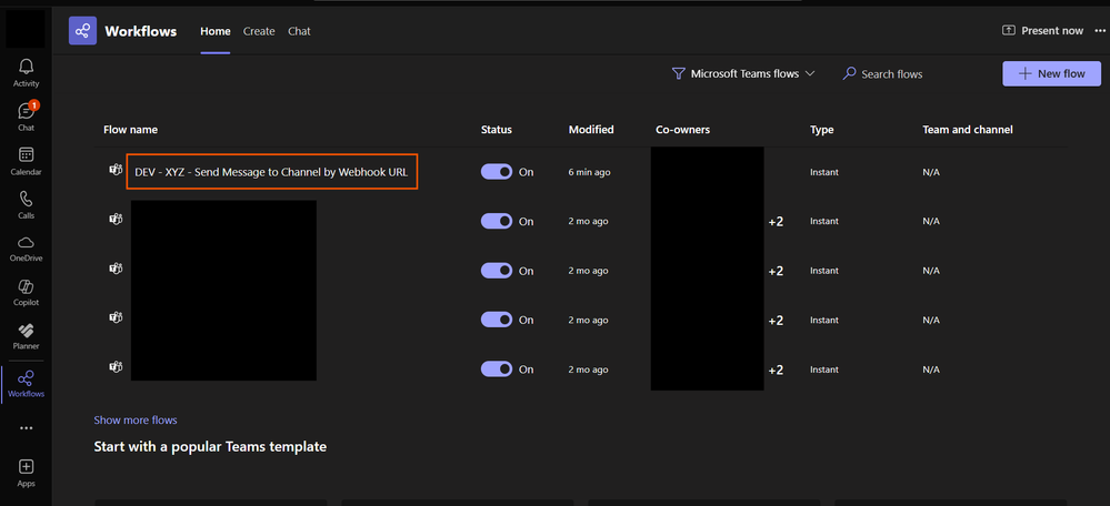

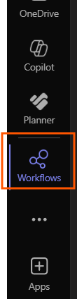

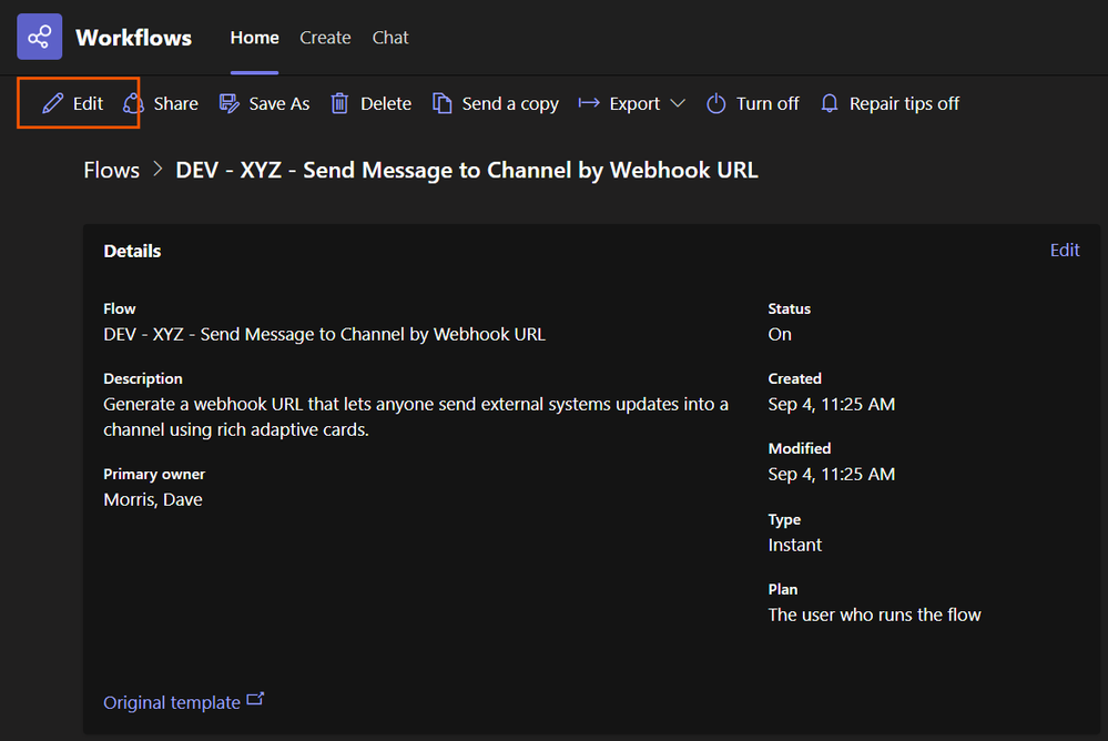

I just noticed you can use the Workflows addon in Teams. I don't know if it's there for everyone, but looks to be an option. If you have it, you'll see it on the left side of Teams in the same list where you see 'Activity', 'Chat', and 'Calendar. Click Workflows. If you don't have this or it is running too slow (classic Microsoft), then you can do the same steps by going to https://make.powerautomate.com and going to 'My Flows' and then 'Cloud Flows'.
If you click 'Workflows', you should then see the flow listed. Click the flow name (it's a link).
Click 'Edit'.

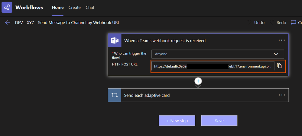

Then you can copy the URL out of the HTTP POST URL blank, and this should always give you the most recent/up-to-date URL even if there is technically still an old URL that still works for the same workflow.

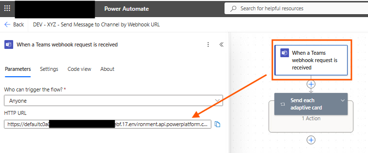

Just to point out, it looks a little different in the browser, and you have to click the card/connector 'When Teams webhook request is received' in order to see a slide out properties pane on the left where you can copy the URL out of 'HTTP URL'.

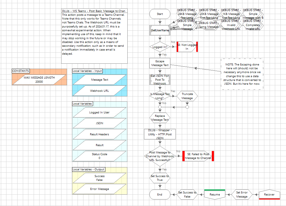

Create An Action in Blue Prism
I'm not going to explain the full details of everything I've done with this as I think that would be overkill, and I think I'm already going excessive here. I also can't directly shared the object I created for multiple reasons, but I believe there's no problem showing the design of the base object so you can create something like it.
I named the object 'DLLib - MS Teams', which stands for Digital Labor Library - MS Teams, and the action is named 'Post Basic Message to Channel'.
Here's the basic action I created, with plans to create more complicated actions in the future if we need it.
The action appears to not work if the machine is not logged in. I don't know why that is since it's just calling an API. But because of that, I have a check to see if the currently-logged-in user is SYSTEM or not. If it's SYSTEM, we're not logged in. The GetUserName code stage is just doing this:
username = Environment.UserName;
The Escape Message Text step is calling an action that does this to the text that is being posted. You'll need the external reference Newtonsoft.Json.dll and the import Newtonsoft.Json at least. If this doesn't work for you, just look up any way of escaping a string for things like backspace, form feed, newline, carriage return, tab, double quote, and backslash. A better solution to this would be to use a C# class to convert from or even use a Blue Prism collection that you nest the adaptive card fields in and then convert to JSON. Apologies if this doesn't sound like much help, but I'm thinking this helps get most people further than they would be without this help at least.
result = JsonConvert.ToString(stringToEscape).Trim((char)34);
The Get JSON For Post To Webhook code stage has this hardcoded in it and outputting it as Text into the data item [JSON]:
adaptiveCardJson = @"{
  ""type"": ""message"",
  ""attachments"": [
      ""contentType"": ""application/vnd.microsoft.card.adaptive"",
      ""content"": {
        ""type"": ""AdaptiveCard"",
        ""body"": [
            ""type"": ""TextBlock"",
            ""text"": ""<MessageText>"",
			""wrap"": ""true""
        ""$schema"": ""http://adaptivecards.io/schemas/adaptive-card.json"",
        ""version"": ""1.0""
Then I'm just checking to see if the message is longer than 20k characters as this is close-ish to the message length limitation at the time that I made this action.
Then I am replacing <MessageText> with the actual message text like this with a Blue Prism expression:
Replace([JSON],"<MessageText>",[Message Text])

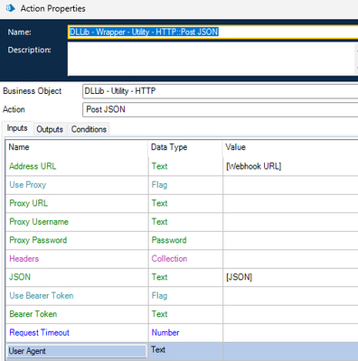

Then I am calling the Utility - HTTP object action 'Post JSON'. I don't remember how old this action is, but it is in the latest version of that object at least. I may have edited it, but I can't remember. The only inputs needed for this as the webhook URL and the json.
Then I'm just checking whether the Status Code response starts with a "2" indicating success. I have it recovering any exception and just writing to the session log if it fails, and then it outputs Success true/false so the calling process can decide whether an exception needs to be thrown or not.
