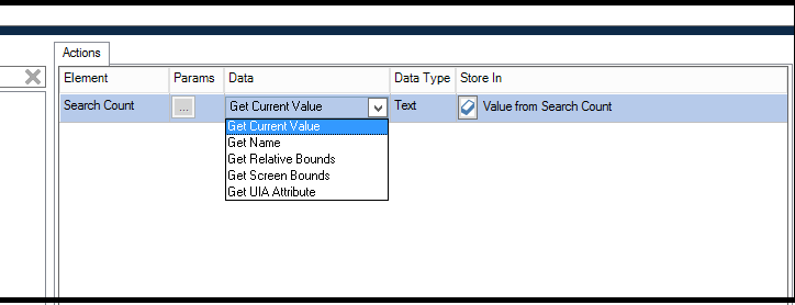

But I don't see any option for reading as text data item.
Swati Agrawal
Hi Swati
The "Get current value" will read the item but you set you data item to be text. In this case you data item is called "Value from search count" you need to set this to be text and the read will pass it into this.
