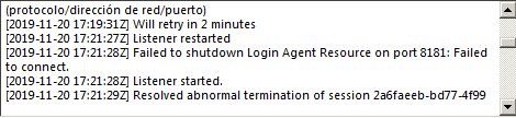

Hello ppl!
This post is only to see different points of view and what you recomend using Login Agent.
We are using the Login and Logout through the scheduler in a simply secuence "Login" On Complete -> "Process" on complete -> "Logout" On Complete ->Stop.
What I said above is what I think are good practices using login agent (perhaps Im wrong)... so we are in a client that is telling us to put the Logic Login/Logout inside the process flow and also the bot has to be capable to restart himself when it reach an X number of operation and then continue with the process. But is this even possible? I created a process test, but as I thought, it failed throwing this error.
The process consist in a process stage calling the login, then a Sleep (simulating the post completion delay that scheduler has) and then send mail, but as I said, it failed.
As far as I know the runtime resource is down when the machine is logged out, when the login is completed and the session had started, the runtime resource start (if was programmed as an automatic task). in this point is where the resource is capable of receiving work
Is possible for a process to restart himself changing between login agent and runtime resource?, If so, what am I doing wrong?

[2019-11-20 16:18:36Z] Listener failed : Unable to start listener - is this machine already running as a Resource PC? : Sólo se permite un uso de cada dirección de socket (protocolo/dirección de red/puerto)
