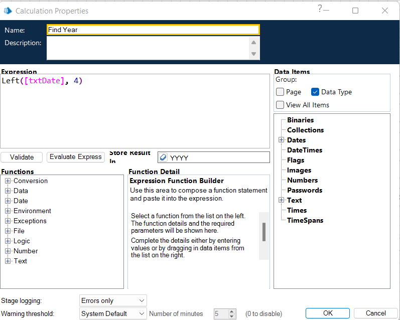

15-09-22 07:46 PM
Hi @Helaria Shaningwa,
You can
For finding year:
For finding Date:
For finding month, since we know that it will always be after 4th character and its format is MM (2 characters) hence:
For performing final calculation:
Please let me know if it doesn't work for you.
Manpreet Kaur
Manager
Deloitte
You can
For finding year:
For finding Date:
