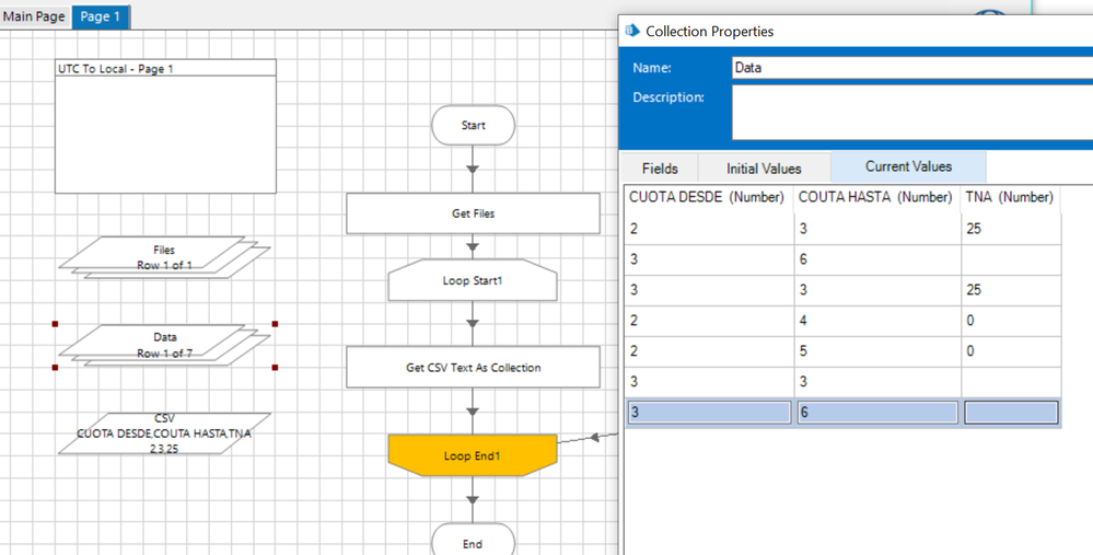

Cuando uso la acción "Get CSV text as a Collection" me escribe las R como 0. Este input se encuentra separado entre comas nada mas. Como hago para que escriba en la collection R y no 0?

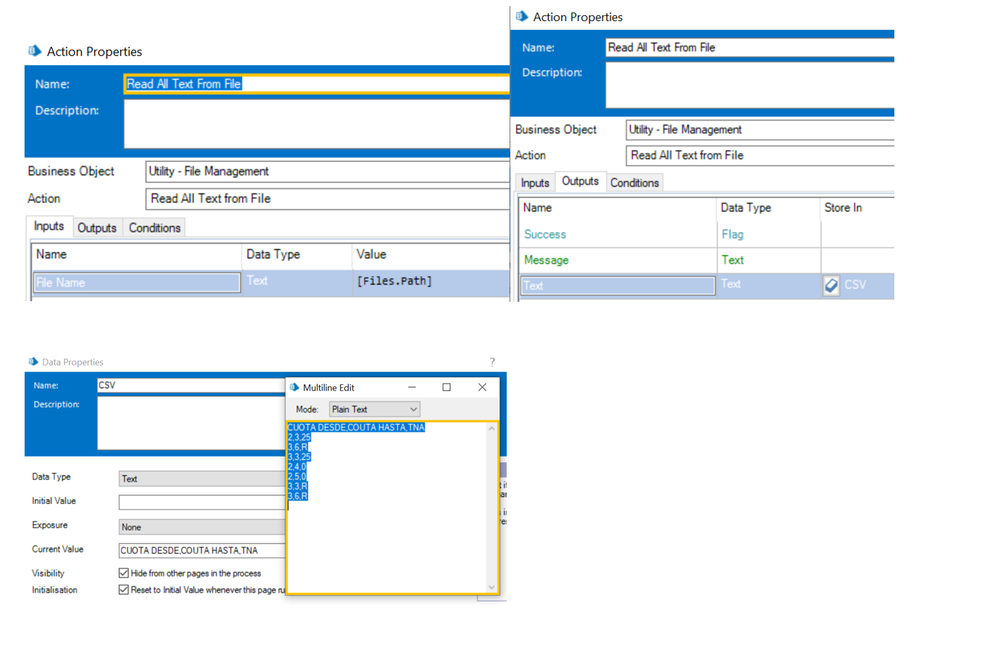

So here I am using first the 'Read All Text From File' action in the 'Utility - File Management' VBO itself which will return me a text data item with the exact text content as shown below:

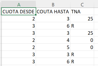

First I use Get Files action of Utility - File Management and then Get CSV Text as a Collection. In that collection is where i get the "0" instead of the "R". I´ll attach a picture of the data in excel as I think this is where the problem arises but my client cannot make changes to it so all i have left is to try fix it in BP.

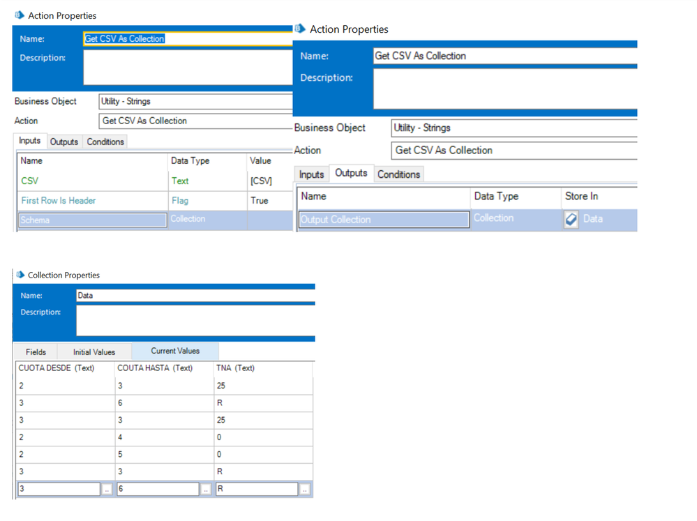

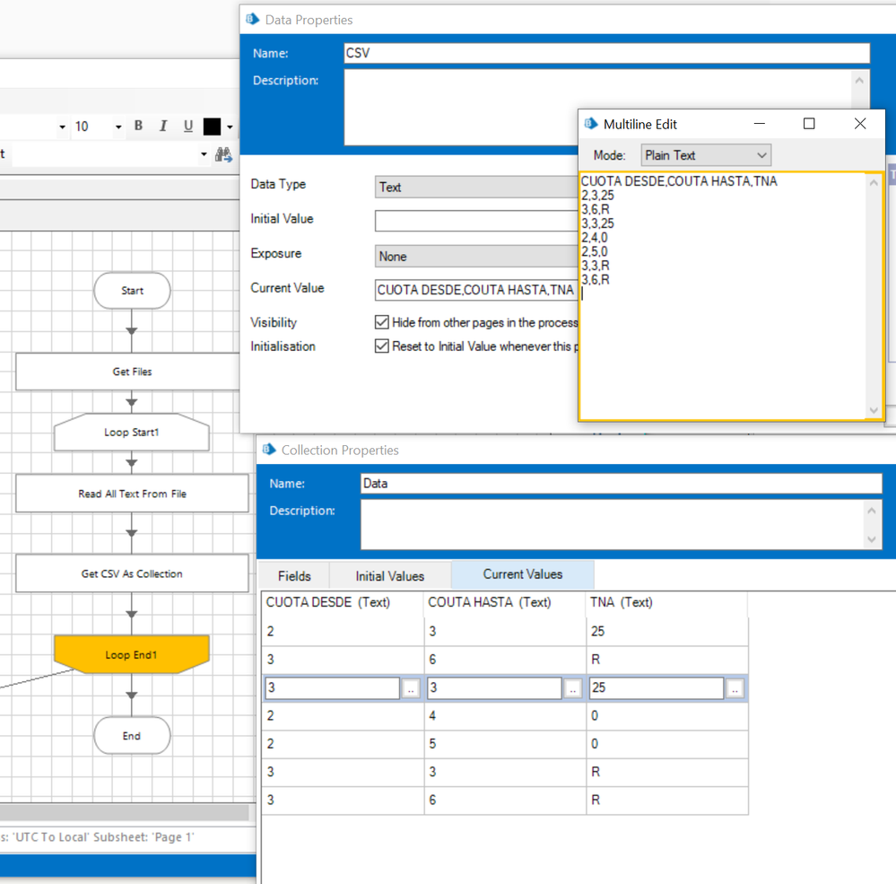

On the other hand, when i use "Read text from file" the Data doesnt recognize "ñ" or words with an accent mark, so if i try to use the old collection to store this data i cant, because it already has fields that doesnt match. Ill attach everything, hopefully you understand.

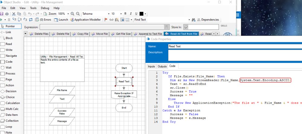

For the special character not being read properly issue, you can go inside the 'File Management' business object and go to the action 'Read All Text From File' and then in the code stage make the modification which I have highlighted once:
NOTE: I would recommend to create a duplicate copy of the File Management business object and make the changes there and use that so that you don't mess up the original business object if it used by some other bot in your environment.
Your updated code should look like below:
Try
If File.Exists(File_Name) Then
Dim sr As New StreamReader(File_Name,System.Text.Encoding.ASCII)
Text = sr.ReadToEnd
sr.Close()
Success = True
Message = ""
Else
Throw New ApplicationException("The file at " & File_Name & " does not exist")
End If
Catch e As Exception
Success = False
Message = e.Message
End Try
Here, I have just added an extra parameter called as '
' which will try to change the encoding format while reading your text file so that other special characters can be recognized.For the other issue related to the loop part, no that most likely won't be the case because what we are getting right now is an undefined collection in contrast to what you had previously with you called as a defined collection. No matter what type of collection we have, looping should be possible as long as you have rows in that collection and if you are using the correct 'Collection Name' in your loop stage. Since the names of your collection are identical the old one and the new one it might be the case that why is it take an incorrect collection. I would first suggest to check the names and make them clearly distinct from each other.

I love this kind of spanish problem 🙂
Just add to the Devneet's explanation, when you "translate" the encoding from a file from one to other, this may cause some characters to be "lost". When I need to read text, usually we use the UTF-8 encoding. If you are not pretty sure of with encoding you have in the file, or problably have a lot of types, you can use the encoding default.
System.Text.Encoding.Default
Hope this helps you!!

01-06-22 07:04 PM
This is what ended up working for me, muchas gracias!!
