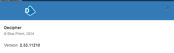

douglas.h.burke
@Ben.Lyons1 I am using version 2.3. Here is the screenshot from the about section for the full version.Decipher version.png
Ben.Lyons1
That's strange, 2.3 should get the vector and ocr data.
