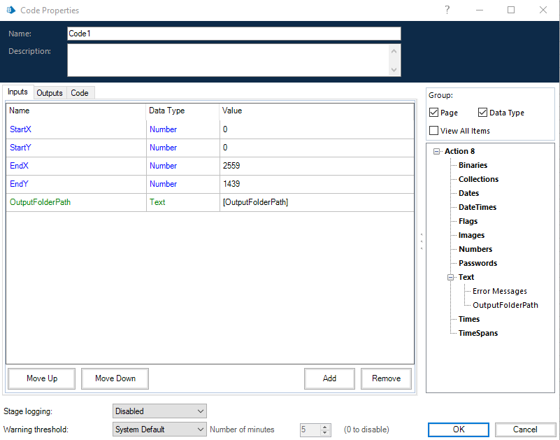

I am using above code to capture screenshot of the screen, where i am passing parameters startX, endX, startY, endY, OutputFolderPath.
this code was working fine for last couple of months but today when i run the bot got this error:
Internal : Could not execute code stage because exception thrown by code stage: The operation completed successfully
please help with this.
