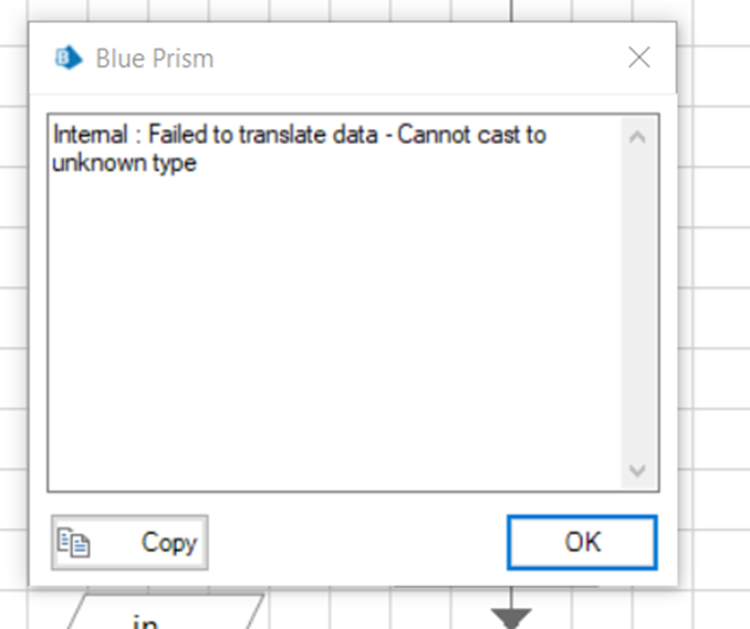

Internal : Failed to translate data - Cannot cast to unknown type while reading the data

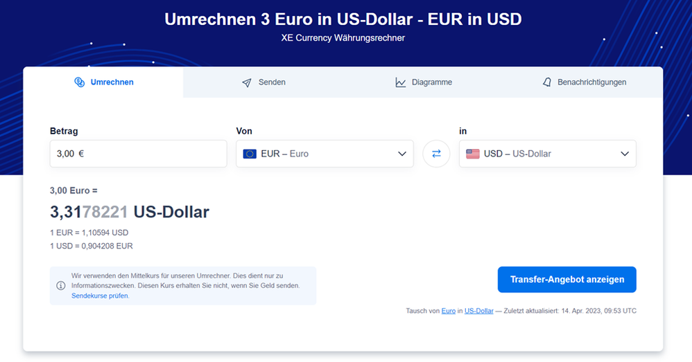

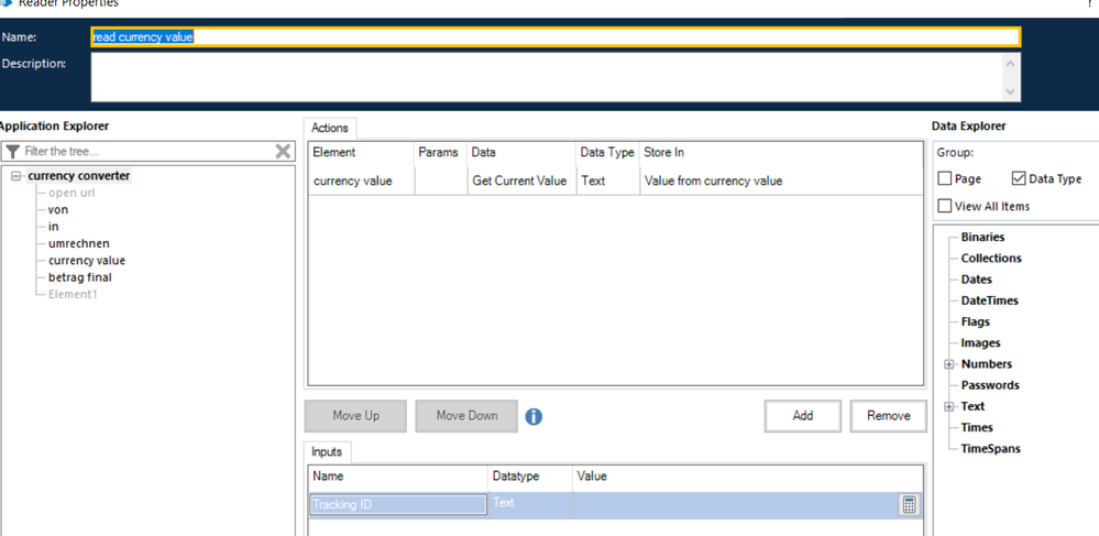

I am new in Blue Prism. While practising, I encountered a problem in web automation. I need to pull out currency value from the website. I used "read" skill to pull the data from the website. Unfortunately it shows an following error. Can anyone help me where is the issue?
Website:
Währungsrechner | Live-Wechselkurse von Xe

You need to define the data item type.

Anonymous
Not applicable
thanks for the information. It works perfectly.
