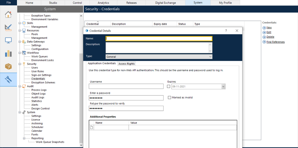

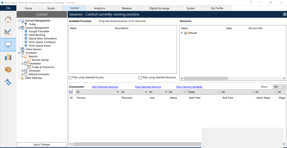

    In Blue Prism there is an  in build Process Management section that is "CONTROL" .Where all Processes designed in Studio are managed. Here we can Run a Process in required Machine, Schedule, Configure Queues, Configure Machines. To create Credentials we have to go to "System > Security > Credentials" in Blue Prism Tool . Attached are interfaces of Control and System-Credential.
