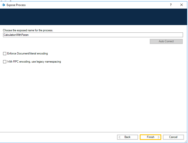

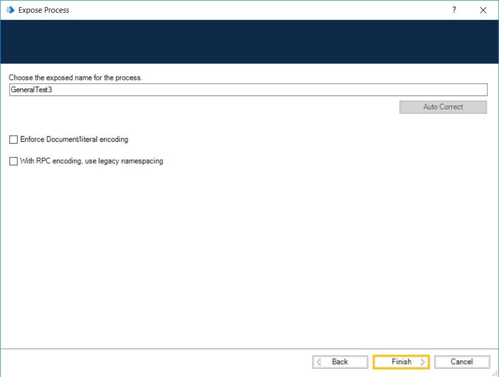

Another question, when you exposed the process what options, if any, did you select within Blue Prism? Here's a screenshot of the process options page. Did you select either of the checkboxes?

While exposing process, I didn't checked any check box.

I assume you're doing all this testing on your local machine, is that correct? If so, do you have access to a separate machine that you could try exposing that VBO on? The only other thing I can thing of would to try checking the Enforce Document/Literal Encoding option and see if that works for you.​
Hi Eric,
I have Blue Prism installed on separate Virtual machine and I am invoking it via other development machine. And we didn't enabled "Enforce Document/Literal Encoding" option. If I enable this option then wsdl format changes. And we are working to dynamically parse any wsdl and invoke process. I tried by enabling "With RPC encoding, use legacy namespacing". But it give me same error.
