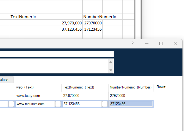

This is indeed an interesting one. From my side because I do not see different functionality between the two actions. Both are doing exactly the same function on my setup.
Now, I have created a collection with some data and a couple of columns one of which is a text column and I am placing in values similar to yours with similar formatting. The other column I have made a Number column, and entered the same value. Formatting isn't possible on the number column.
When I run my test process, both actions perform identically. The interesting thing is that the column that is Text, the value in Excel has the comma as the thousands separator and in the correct places, the cell format is Number. The number column has no separator and the format applied to the numeric value is General.
My concern is mainly over the fact that you are getting a different outcome between the 2 actions and I don't. In addition, Excel seems to be working some magic of its own here.
I am wondering if we could devise a way of specifying specific formats for cells would help you at all? I think this is down to what Excel does and its localization factors. There are a couple of possible properties of a range that might be candidates to hold some kind of tag that could be subsequently read by another process and apply a specific format. I am writing out loud here, please forgive me if this is irrelevent to you.
Here is the outcome that I got when I tried an example.
