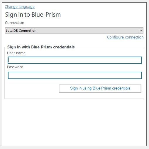

If I understand correctly, when you first installed Blue Prism, you got as far as the following screen:
(Assuming this is what you are referring to as "…went up to connection string setup screen where I was not able to figure out something")
If I've understood correctly (I may not have), it indicates that Blue Prism was installed correctly and then you didn't know what username and password to enter.
Tip: Next time you get this far, the username is admin and the password is the password you choose when installing.
Again (if I have understood), completely removing Blue Prism from your system and install Blue Prism Trial or Learning Edition again should resolve you issue:

Yes , exactly this screen

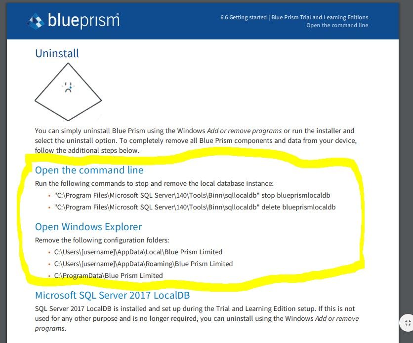

Can you please show me any article or blog on how to remove it completely?
As I uninstalled/installed many times that didn't help.

Hello Balram,
We've included steps at the back of the Getting Started Guide - Blue Prism Trial and Learning Edition guide on how to completely remove Blue Prism Trial and Learning Edition.
Screenshot below which also highlights the steps that you probably wouldn't have known to do:
The extra steps clear down the Microsoft LocalDB setup by removing the database instance and supporting files.
Chris Strong
Product Manager
Uninstall steps (extracted from the guide)
You can simply uninstall Blue Prism using the Windows Add or remove programs or run the installer and select the uninstall option. To completely remove all Blue Prism components and data from your device, follow the additional steps below:
  1. Open the command line Run the following commands to stop and remove the local database instance:
    1. "C:\Program Files\Microsoft SQL Server\140\Tools\Binn\sqllocaldb" stop blueprismlocaldb
    2. "C:\Program Files\Microsoft SQL Server\140\Tools\Binn\sqllocaldb" delete blueprismlocaldb
  2. Open Windows Explorer Remove the following configuration folders:
    1. C:\Users\[username]\AppData\Local\Blue Prism Limited
    2. C:\Users\[username]\AppData\Roaming\Blue Prism Limited
    3. C:\Users\[username]\AppData\Local\Microsoft\Microsoft SQL Server Local DB\Instances\BluePrismLocalDB
    4. C:\ProgramData\Blue Prism Limited
  3. Microsoft SQL Server 2017 LocalDB
    1. SQL Server 2017 LocalDB is installed and set up during the Trial and Learning Edition setup. If this is not used for any other purpose and is no longer required, you can uninstall using the Windows Add or remove programs.
Chris Strong
