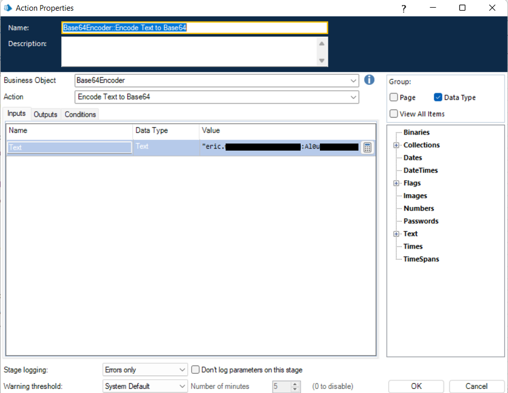

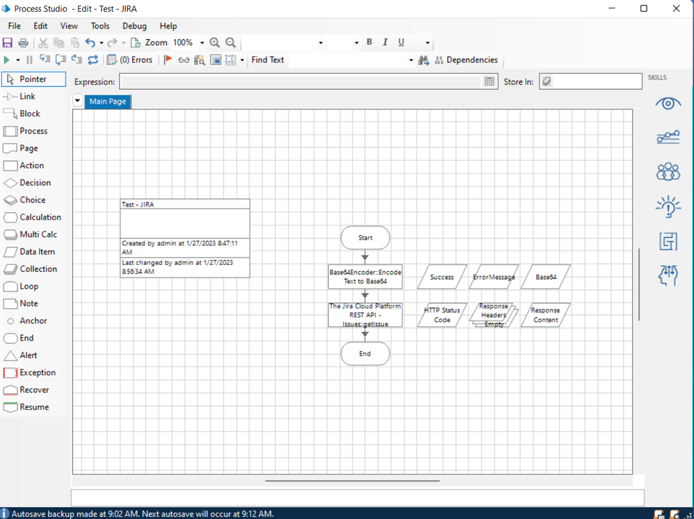

I just realized the original developer of this connector is no longer with Blue Prism. I've put together a quick test retrieving the details of a JIRA issue including the creation of an API key (I am not logged into JIRA via the browser BTW). My test is running as expected and I'm able to retrieve the details of the specific issue. Here are a few screenshots of my little test process:
I've also tested it with getFeaturesForProject action, and that works as expected for me. So it seems to be something with your environment. Can you try creating a new API key under your account?

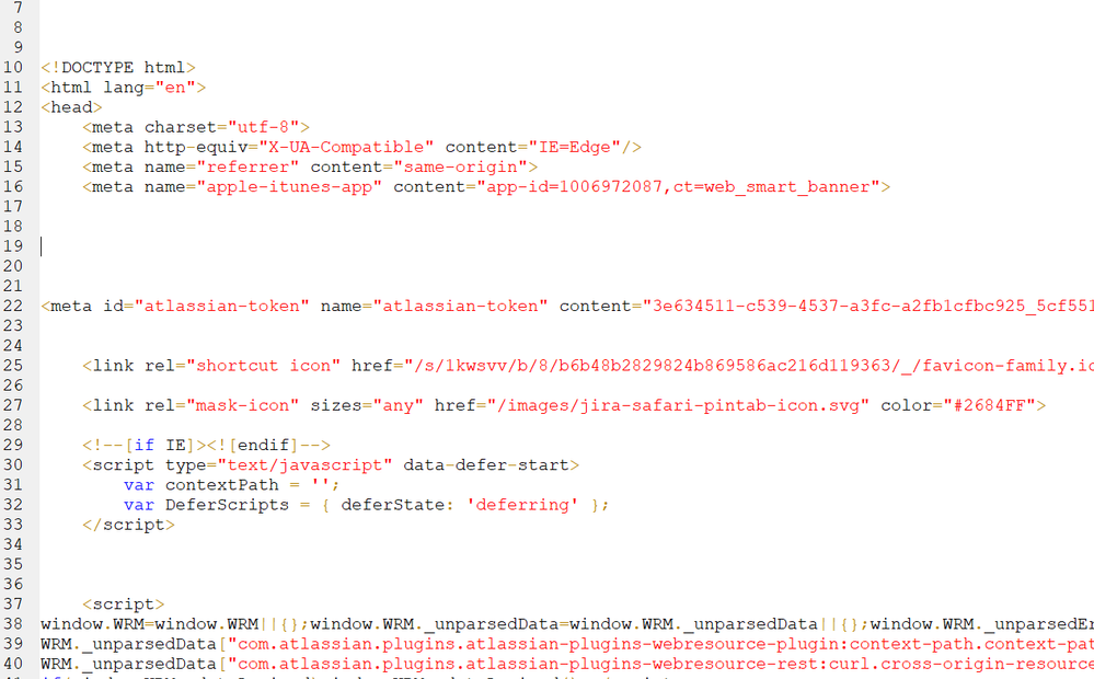

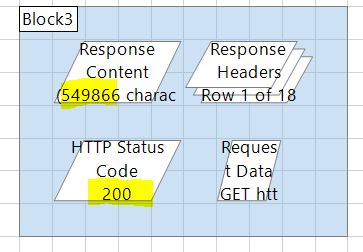

Thank you very much for the above screenshots. I managed to get an HTTP status code of 200 indicating that the authorization is working. However, the Response Content looks not so much like features or issues within the JIRA project, but more like the HTML source code for the web-page. Please see below:
​I'll keep testing, and see if I can figure it out.

That's definitely not the response content​ you should be seeing. 🤔 I'll dig a bit deeper on our side too, and see if there's anything else I can turn up.
