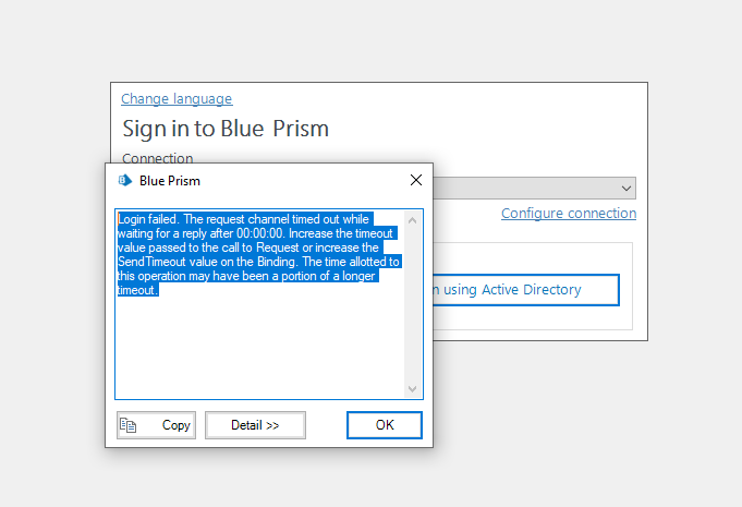

Hi Team,
I have upgraded my application Server from BP 6.10.1 to BP 7.1 and when try to connect from my client machine
ie "Sign in Using Active Directory" i get the below error message
Error Messgae :"Login failed. The request channel timed out while waiting for a reply after 00:00:00. Increase the timeout value passed to the call to Request or increase the SendTimeout value on the Binding. The time
allotted to this operation may have been a portion of a longer timeout."
have any one faced this issue post upgradation to latest version BP7.1??

Update On Above issue:
  • system Admin user is able to login via interactive Client from local machine but Normal BP users are getting the above error event though they have required permission .
    • Timeout error as shown in the original message
