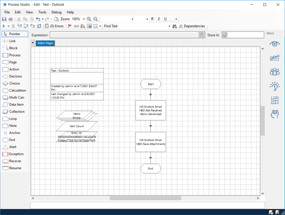

@HowardBlake,
I've tried recreating the condition you mention, but so far I have not experienced it. I'm running Blue Prism v6.9​.0.26970 with the latest MS Outlook VBO from the Digital Exchange (which actually points to the VBO on GitHub). I have a simple process that performs a Get Received Items (Advanced) followed by a Save Attachments. The entry ID I'm using points to an email that contains two PDFs as attachments. I'm saving the attachments to my Temp folder (C:\temp). Everything's working as expected whether Outlook is running before I step through the process or not.
Do you experience the problem if you step through the process in debug as well as running from Control Room/Scheduler?
FWIW - There is another Outlook VBO on the DX from a company called Neoops. You might try downloading their VBO and see if you experience the same behavior. You can find it here:
https://digitalexchange.blueprism.com/dx/entry/3351/solution/neoops-ms-outlook-vbo
Their implementation of the Save Attachments action is quite a bit more straightforward than that of the Blue Prism VBO because it's not attempting any pattern matching on files.
Eric
