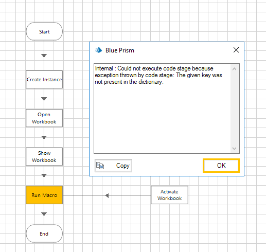

I have created a macro to send the email to employees on completion of their 5 year anniversary.
When i am manually running it, it is working. However, while using BP Run Macro option, it is giving me error as "Internal : Could not execute code stage because exception thrown by code stage: The given key was not present in the dictionary."
How to fix this? could you please assist.

Hi @YogeshSharma1 - I have seen this error usually with the handle - are you trying to use two different Excel VBO Objects for different actions ? The Run Macro action used should be from the same Excel VBO that created the instance in first place.
