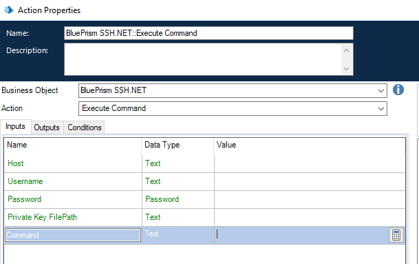

@Bohyon Hwang
Thank you for your reply and May I know what is the Private Key FilePath parameter here? If possible could you please help me from where can I get it?

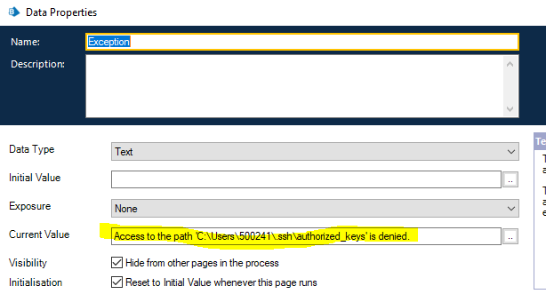

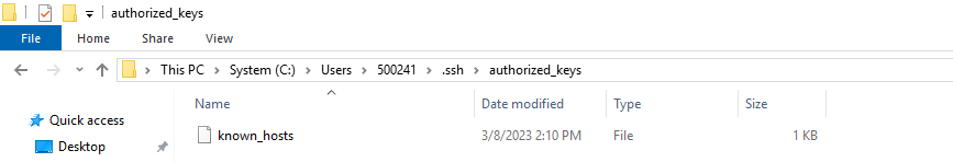

Hello @Bohyon Hwang
This is the folder path where I have placed the file from .ssh folder
I'm trying to run the  below and getting the error as Access to the Path has denied
Could you please help me here?
