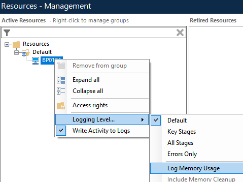

07-12-21 09:18 AM
Hi Max
If you activate the memory logging function for that machine, you might be able to see where and when the consumption creeps up.
And to add to Devneet's advice, check if you are inadvertently leaving 'ghost' instances of excel.exe hanging around in Task Manager.
