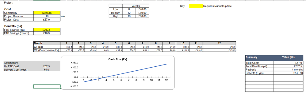

For benefit calculations you do it once when you are aware of the Complexity Metrics, Delivery cost (License, Infra, Dev cost) and etc. The benefits or ROI calculations are done during or after first contact meeting (Discovery Sessions).
We call it payback period modeller or the cash-flow as below: Payback period is time where you start realising the benefits (+ figures), basis on all of these charters or metrics these projects gets approval/sign off from upper management officials to be commenced for development.
Getting in touch with your Discovery team or the Business Analysts would be a good idea here for you.
