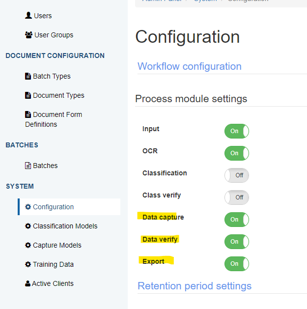

Check under System > Configuration that you have the next stages enabled after OCR. Perhaps that might be preventing it to move ahead.
