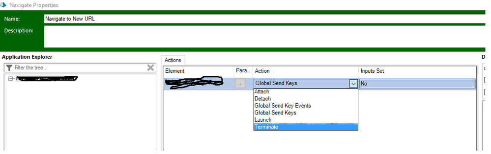

Hi Team,
I am not getting the navigate option for the root element in BP6.10.2 Edge browser.
Would you please help me.

Hi Sasi Kumar,
Thank you for contacting Blue Prism Community.
Can you please provide a snapshot of the symptom?

Hi Sasi,
Thanks for the snapshot.
Can you please share more details on what do expect to see/get in this navigation stage option?

Are you looking for an option to navigate to a new URL using the root node in Navigate stage?​

There is no navigate option is root element . Navigate is a stage where you can use launch option to jump to the desired application .

If you're looking for the option "Navigate URL" that was in IE automation which was used to navigate to another URL, that wasn't at the root node even in IE. But anyway in Edge automation, it is called "Set Address", and you need to use a browser mode element for the option to show up in the dropdown for an action to perform.
