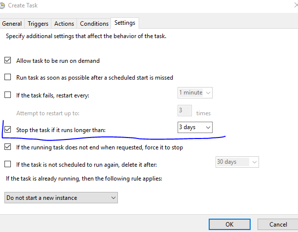

Hi Eric,
Are You using task scheduler to launch Runtime Resource Agent? If yes then please check task settings - for example You may have set it to stop after couple of days as per attached screen.

Hi Michal,
Thank you so much for this information!!! I have fixed this setting for the runtime resources. However, it is still somehow suspicious that our resourcepc goes missing with a period of 7 days... I even created a dummy scheduler task that runs every 30 minutes try to pin point a time slot that this happens. So far it only happened three times and I do not have a steady time slot yet.
But still, thank you so much! This solution seems very promising.
