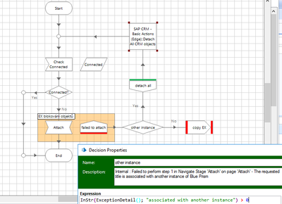

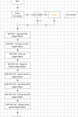

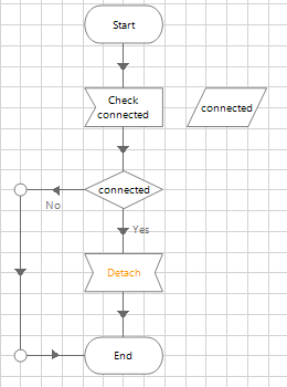

Here I post the detaching logic we implented as it might be useful for someone who bumps into same problem in the future.
  1. Each object gets a simple Detach page which gets published as an action. This action is NOT called by processes.
  2. Each action starts with calling attach page of it's own object, which tries to attach as ussual.
  3. If attach fails then "Detach All" action from "Basic Actions" objects gets called.
  4. This "Detach All" action calls all the detaching actions.
  5. original objects tries to attach again.
This way we didn't need to change our existing procesess. And our developers don't need to pay special attention to detaching while working with this exceptional application.

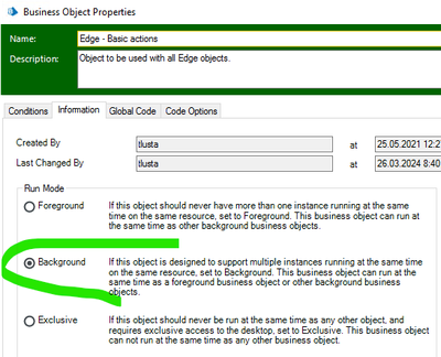

A) the detaching is simple as possible.
B) Blue Prism may indeed start multiple instances of the same object.
This is affected by the "run mode" setting of the object. Despite of what is written in the description and documentation, it seems that if you call an object by multiple different objects or process+object (and you want to have just 1 instance) you should choose the "background" option.
At least that was the behaviour in the previous versions. But since our detaching mechanism works it probably still works that way. All the CRM objects have this mode selected.

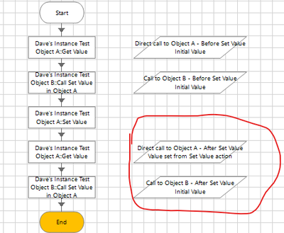

Hi @StanaST, thanks for explaining that. You got me looking into this obsessively. It affects how I design automations to a significant extent. If Blue Prism really does have a way to make it so only one instance is created per object, I think I would love that. The thing is that I always set my objects to background mode for utilities, and I've experienced it being that separate instances are created depending on the level it is called from.
Would you mind importing the attached release into your environment? What I did was just create some simple logic. I did this using 6.10.1 and then imported into 7.3.1, and both show the same results for me.
If Blue Prism uses the same instance for Object A regardless of whether it is called from the process level or from Object B, then the two circled data items should have the same value at the end. Take a look at it and let me know if you have the same results. I feel like we may not be talking about exactly the same scenario, and I'm hoping this will shed some light. I may not be testing this the way you'd expect or maybe there is some other difference.
I can't overstate how much I would love it if I can make each object have only one instance. 😃
