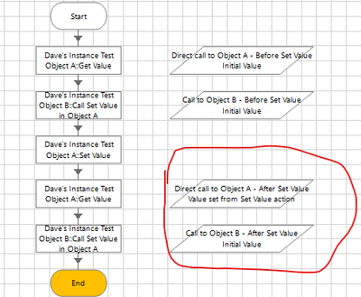

Hi @StanaST, thanks for explaining that. You got me looking into this obsessively. It affects how I design automations to a significant extent. If Blue Prism really does have a way to make it so only one instance is created per object, I think I would love that. The thing is that I always set my objects to background mode for utilities, and I've experienced it being that separate instances are created depending on the level it is called from.
Would you mind importing the attached release into your environment? What I did was just create some simple logic. I did this using 6.10.1 and then imported into 7.3.1, and both show the same results for me.
The Blue Prism community isn't letting me put the code directly in here for some reason, so I uploaded it to GitHub here:
https://github.com/DaveTheRpaGuy/BluePrismInstanceTest/blob/main/6.10.1_Dave_Instance_Test_2024.10.01_1128ET.bprelease
If Blue Prism uses the same instance for Object A regardless of whether it is called from the process level or from Object B, then the two circled data items should have the same value at the end. Take a look at it and let me know if you have the same results. I feel like we may not be talking about exactly the same scenario, and I'm hoping this will shed some light.
I can't overstate how much I would love it if I can make each object have only one instance. 😃
