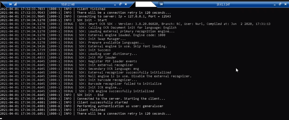

We have setup Decipher using Multi environment and when i push the documents for the very first time, the status of the batch remains as "Waiting for Image Processing" and does not move further.

4. Regarding the screenshot, i get different info when i run SsiImageProcessingClient.exe file. Below is the screenshot.
{Screenshot-1 Attached}

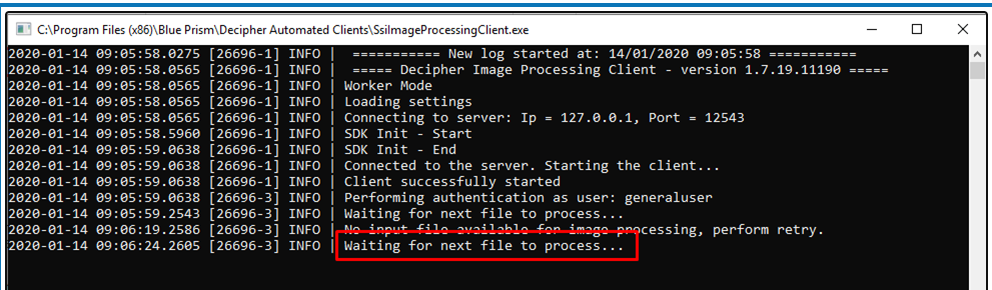

35097.pngThis screenshot is different from what is given in the trouble shooting document which is -
{Screenshot-2 Attached}
35098.pngStill I am facing the issue of "Waiting for Image processing." We have restarted all Decipher and RabbitMQ services but no luck.
Request anyone to please let me know what else needs to be done for the Image processing to perform.
