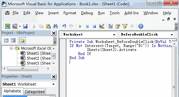

Hi Shweta,
That cell probably is invoking a macro code written behind it which means you can look for the code behind it and try running the specific macro from the process and use : MS Excel VBO action - Run Macro when replicated it should look something like this :
Private Sub Worksheet_BeforeDoubleClick(ByVal Target As Range, Cancel As Boolean) If Not Intersect(Target, Range("B1")) Is Nothing Then Sheets("sheet2").Activate End If End Sub
You can search for code in that cell as below it will route you to the specific macro behind that cell and you can even activate the cell inside the code itself or Action - Go to Cell and then use custom code to activate it

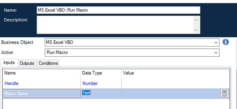

In case if your unable to spy anything via blue prism, please try below approach as a last option if the excel file is always same.
whatever excel cell if you want to double click, develop a macro by using recording option and later execute the macro file by using below blue prism utility
