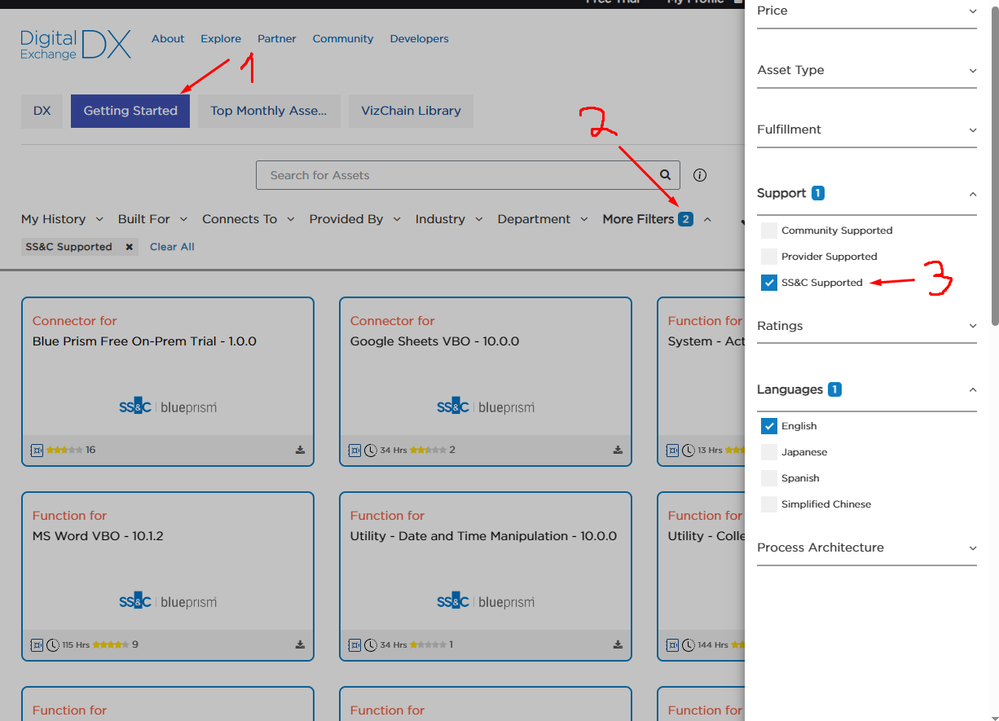

Regarding your question, it's important to note that the latest versions of Blue Prism no longer provide VBOs (Virtual Business Objects) in the post-installation folder. Now, to obtain these basic utilities, you need to access the Blue Prism Digital Exchange (DX) portal and download them manually.
I recommend visiting the portal at https://digitalexchange.blueprism.com/dx/search/getting-started, where you can find and download the desired VBOs for importing into Blue Prism.
Attached is a screenshot with the step-by-step guide to finding the VBOs:
If you need further assistance or have any questions during the process, feel free to reach out-I'm here to help!
