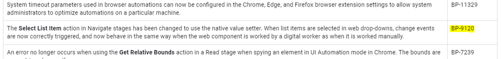

- Before manifest V3 we used to use the Invoke JavaScript action for triggering change events when working with Web List items, but have since replaced this with UI and Send Key actions (not the most aesthetic solution, but it works). In the Release Notes of V7.2 we came across improvement BP-9120 (see below screenshot). Does this improvement imply that from V7.2 the triggering of change event by setting a value in a Web List is supported by the native Browser Extension? Or do you still need to use Invoke JavaScript to accomplish this and thus will need to install the Edge WebDriver?
