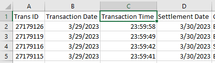

Hi ,
I'm using the SQL query in OLEDB to get the Excel data but when I read the excel data in Blue prism I'm getting the difference in Date and Time values and I'm not getting the exact Excel Data in the Blue Prism Collection
Please find the below excel screenshot and Blue prism collection Screenshot
Could you please provide the exact solution for this ?

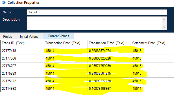

Hi @mukesh kumar
I have tried the code stage to convert the excel columns to Text , even converting the values to text I'm getting the  result as shown in the below screenshot and as expected on from the excel
Before Converting to Text:
After Converting into text:14294.png
Could you please help me with the right approach?

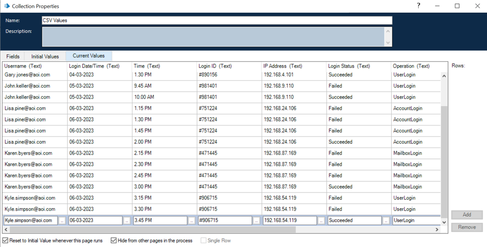

if your requirement is processing of all data then try below approach
>> getting the data in parts by using "Utility - File Management"::"Read Lines From File" defining a range of lines (10000 or more) at a time  based on your requirement
>> Renaming the collection field to "Item Value"
>> combining the lines into text "Utility - Strings"::"Join Lines"
>> use "Utility - Strings"::"Get CSV As Collection"
>> iterate the the process until you get end of the file flag as true by increasing the range.
but if your requirement is getting specific data by filtering then you have to go for oledb defining the filter and later either you can use code stage to change the datetime values to local for whole collection or each value in loop with calculation stage by using datetime function again that depends on you requirement
so for better solution give the exact requirement so that somebody can provide  you a better solution
Note : connection string of OLEDB for CSV file "Provider=Microsoft.ACE.OLEDB.12.0;Data Source="&[Path]&";Extended
Properties=""text;HDR=YES;FMT=Delimited"";" in the path you have provide until folder only end with "\"
query would be like "Select * From [Book1.csv];" where Book1 is file name

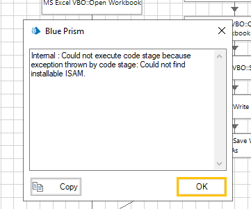

Hi
Can you please check the connect string if possible paste the old connection which was working for excel file  and the new connection string you got error
path used for csv file in connection string
Regards
