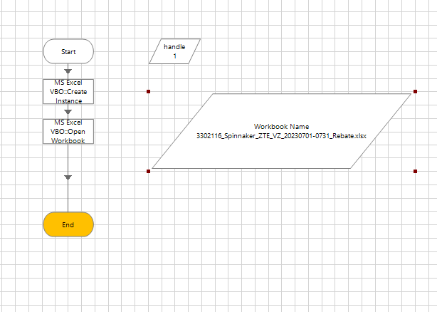

Dear Erika,
This is strange, Even I have created a test excel with name of "3302116_Spinnaker_ZTE_VZ_20230701-0731_Rebate" and its working fine.
Please confirm which version of blueprism are you using it?

To get the workbook name I use the split path option instead of using Blue Prism Excel VBO Open Workbook output parameter.
