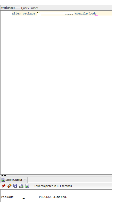

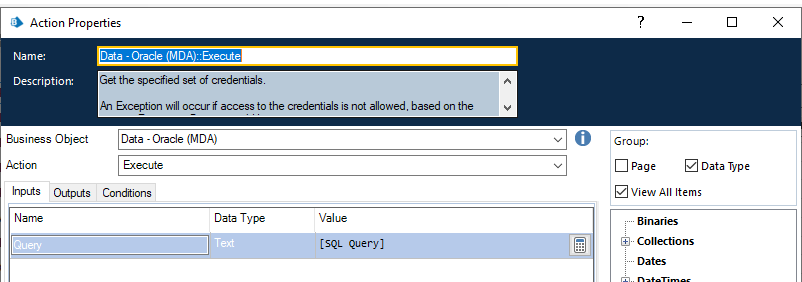

I'm using Data - Oracle (MDA) VBA to execute the one of the Query to alter the package but it's giving the error like Operation is not valid due to the current state of the object. and I'm using the Execute Action from the VBO.
My Query looks like this for example
alter package ABCD_XYZ_ODI_PROCESS compile body
if I run the same query from the Oracle SQL it's giving the result for me
Could you please help on this?

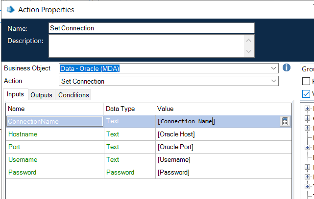

2. In your process, have you set the connection parameters to connect to your Oracle system?
Yes we have set the connection parameters and it's working perfectly

Could you show an image of your process that you are using so that I may see its component parts? I need to establish how the execute is being called and what is different about the SQL you are sending. In the meantime, I am configuring an Oracle VM here to try to replicate your problem. Once I am able to replicate it, we can go about finding you a solution.

I have been working on your problem and I have discovered an issue with the asset, in particular the execute. I have made some additions to the asset and updated the example process. I will be updating the documentation soon and then I will post this update to the Digital Exchange. Once it has cleared QA it will be available for download. I expect this to be in the next few days, possibly early next week.

Dear @Geoff Hirst
Appreciate your efforts for resolving the issue with the Execute function.
After using the latest version of Oracle MDA , I'm getting the result as success after executing the Query with the Execute functionality.
