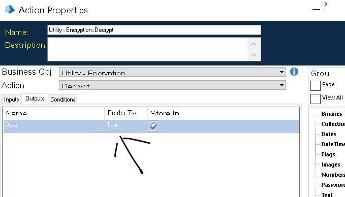

Hi Dave,
I have gone through the VBO's, and the DB.
I am able to find the encrypted screenshot in the DB ([BPAScreenshot])
I am also able to find the encrypted Key in the DB. ([BPAKeyStore])
However, the Encryption VBO has output as text.
So not sure how it can save the image. May be a custom code will help.
