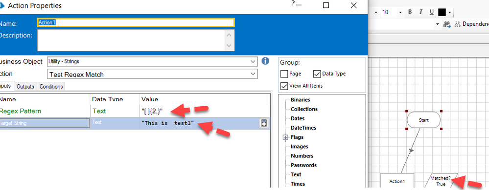

HI Rhian,
If you want to check the spaces two or more you can use this regular expression pattern -  "[ ]{2,}"
You can use instring  function  to verify this - "the usual O instead of 0."
