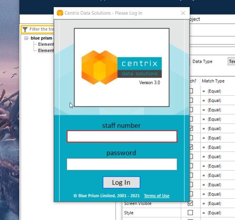

34930.jpgI am new to blueprism and took up the foundational training. While following the training course, I came up with Identifying elements. But for some reason, the spy mode doesn't accurately represent the actual field according to the position of my cursor. Any help for this problem would be appreciated.

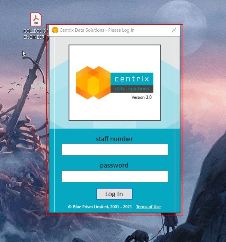

I do understand the role of attributes. But in my case, I am facing the problem of even selecting the field. For instance, when I mode my cursor to the "staff number" field, it is not highlighted. It only gets highlighted after moving my cursor a few centimeters above that field, as seen on the second screenshot.

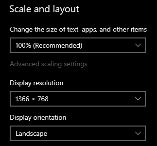

This will be the scaling on the machine. Right click desktop, go to Display Settings and ensure Scale and layout is set to 100%.
Yes, exactly this only happens due to display settings. Set it to 100% and reboot your machine and try to highlight any element. Still issue persists please do let us know here.

Moving the cursor outside of the field is a common thing when working in blueprism and can happen in some spy modes. This is most notable in spy modes like html because things live div tags often represent a much wider field than is shown on the screen and a what looks like a single element on screen might have more than a single tag in the html code. For example the immediate field might highlight as and in the attributes be a span tag but just outside that might also be highlighted and show as a div tag and spying either of these will work to populate the same field when running in blueprism. It shouldn't affect your development and you should be able to enter values into fields when running the process but it is something to be aware of when developing, if you come across a field that isnt being highlighted move the cursor gradually outside the field until the field lights up
