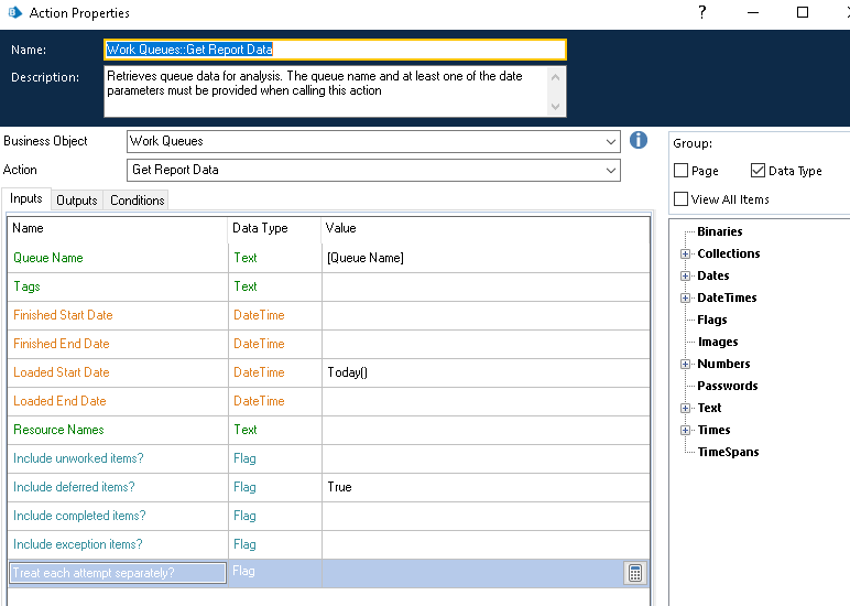

At first glimpse of your screenshots it looks like the process competed at 10:27:59 therefore not picking up an item that had been deferred until 10:28:00?
Maybe a bit more of a description of what was expected and what is wrong might help me understand the issue better. An understanding of the expression in your decision stages and the data items being evaluated might be needed to understand the decision result.
Denis Dennehy
Head of Professional Services, EMEA
Blue Prism Ltd
Process is checking for deferred items in queue and if there is any - trying to get item, otherwise exits.
It looks like at 10:27:59 that last deferred item became active, number of deferred items became 0 and process just stopped instead of attempting to work on it.
However, there is no point trying to get deferred item - you won't get it until it becomes active (unworked). And when it becomes active, it stops being deferred and process will miss it. It might only work sometimes if race condition happens - item is still deferred when report data is collected, but not anymore when get item is called.
Include unworked items in Get report count, then process wont miss it.
I'd also stop hammering database for queue data multiple time a second and add reasonable delay between checks when there is no active items to work on:
1) Do we have unworked items? - Get Item - Do stuff - Repeat 1
2) Do we have unworked or deferred items? Wait 5-10 secs and go back to 1, otherwise exit.
Both in (2), because you might also get a race if you only checking for deferred.

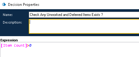

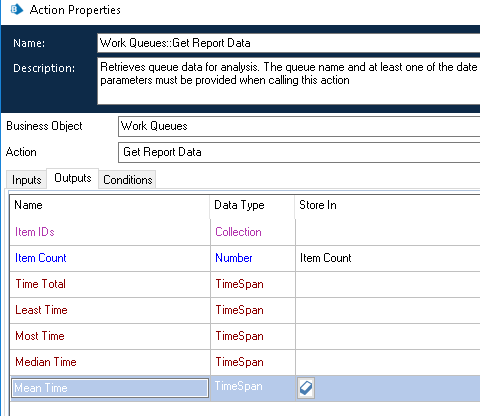

Is it fine if add the checks as shown below ?
1, After checking only deferred items in Queue, if it goes for a No Condition.
2. Then, Wait for 5 Seconds.
3. Again Get Report Data and check for Unworked and Deferred items both.
4. if Item Count Exists -> Get Next item -> Perform the Activity.
5. Else End the Process.
