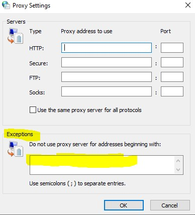

Error Message2: This issue will occur if you specify the proxy for the bot user. By going to Internet Options Connections LAN settings you can see if there any proxy settings set for the bot user (This setting will change from user to user you have to login with bot credentials to check these settings).
As shown in the below screenshot disable the "User automatic configuration script" & "Proxy Server" if it is enabled
When the proxy is enabled and cannot be bypassed (for security reason), add the BP Application Server (eg: myserver.blueprism.com) in the list of Exceptions( Internet Options > Connections > LAN settings > Advanced)
