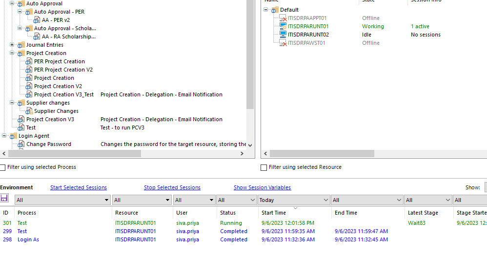

06-09-23 06:54 PM
The machine is up and resource pc is up. While dragging other processes, it is showing up in the Sessions window and is able to run. But only one set of processes (highlighted in the below image)is not showing up. The highlighted processes are having issues. For Project Creation V3 process, created a new instance of it (Project Creation V3_Test) while importing and still failing.

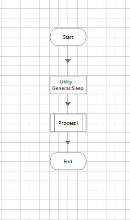

06-09-23 07:11 PM
Tried calling project Creation V3 from another Process called 'Test' and it seems working

07-09-23 01:36 PM
Hi Sivapriya,
Thanks for the sharing the screen shots,
During the initial post which you mentioned, scheduler is not working but now your highlighting different issues.
Can you please provide more clarity about exact issue? whether it's related to scheduler or else while drag and drop some of the processes are running and some of them session entry itself not creating?
