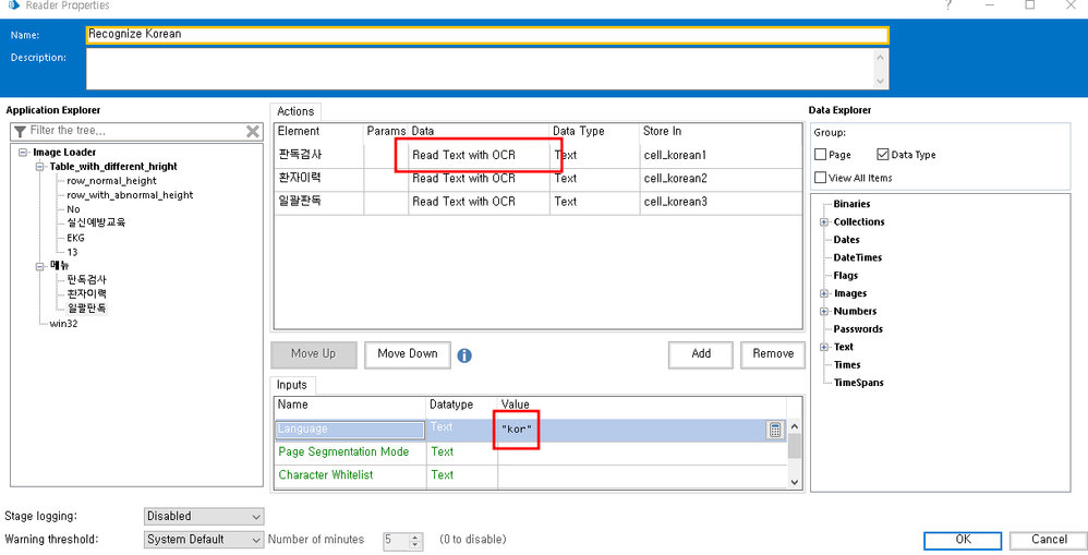

While I was testing the Read Text with OCR action from Read Stage,

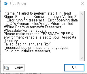

I came across the following error:

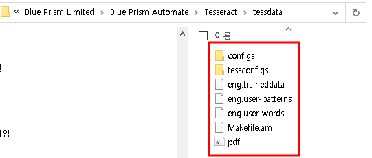

I did check out the corresponding folder and found there's seems no dataset or relevant data for Korean.

Yes, Read with OCR could be made compatible with Korean. It's supported by tesseract.
You just need to download the Korean Traineddata from here: Traineddata Files for Version 4.00 + | tessdoc (tesseract-ocr.github.io)
And add the file to here: Optical character recognition (OCR) (blueprism.com)
Let us know if it works. Good luck!
