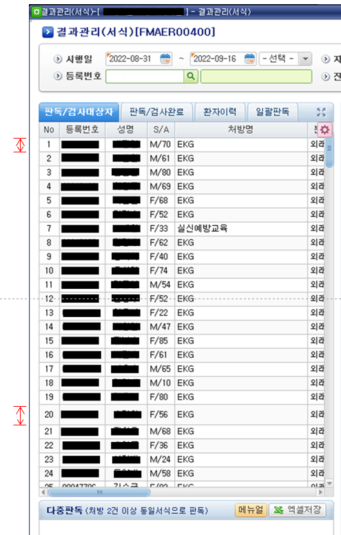

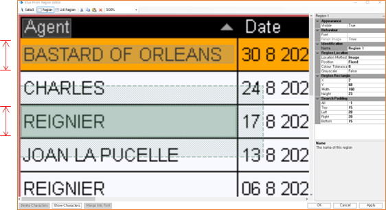

Is there anyone who has spied the table with varying height of a row?
According to the training lecture for surface automation, position of each row in the table can be obtained by moving the coordinates of {START Y, END Y} downward along the table. In this case, the assumption is the row height is same.
But, in this actual case of our customer, the row height is varying based on the length of contents in the box of the row. Therefore it seems not possible to calculate the right position of the row in the table using the constant value of row height.
Does anyone have a tactic to robustly obtain the position of the row in the table where the row height can vary?
Your help would be much appreciated.
Best regards
HongJoo Choi

Thank you for the comment.
Actually, the height of the row varies depending on the content contained in each row and the content itself is input by users (i.e., doctors in this case)
thereby there can be more than one nth rows  and it's position also varies.
Best regards
HongJoo Choi
Hi @ManpreetKaur1
Thank your for the response.
In this use case, reading the content in the cell is not a concern rather it would be enough if we can click the right position of each row.
The detailed scenarios is as below:
1) click the current row (starting from the first row)
2) go to 3) when there's some data to be handled for that item, OR go to 5) when there's no data to be handled for that item
3) upon clicking, pop up automatically comes up, some actions are taken to that pop-up and close it.
4) the current row disappears and the next row becomes the current row, Go to 1)
5) upon clicking, no pop up comes up and
6) the current row remains as it is and should move one step down by clicking the downward arrow. Go to 1)
In a nutshell, the need to locate the next row correctly comes
when there's no data for the current row, and so has to move down to the next row while the current row remains as it is,
at the same time, the height of the next row may or may not be different from the current one.
Clicking each row one by one from the top to the bottom is inevitable action to try to invoke pop-up and take follow-up actions.
My guess is that:
if there's a way to figure out whether the height of the next row is wide one or normal on the fly,
then it might be possible to dynamically determine next coordinates to which the cursor should move down.
I don't have any clue to make this happen.
Best regards
HongJoo Choi
