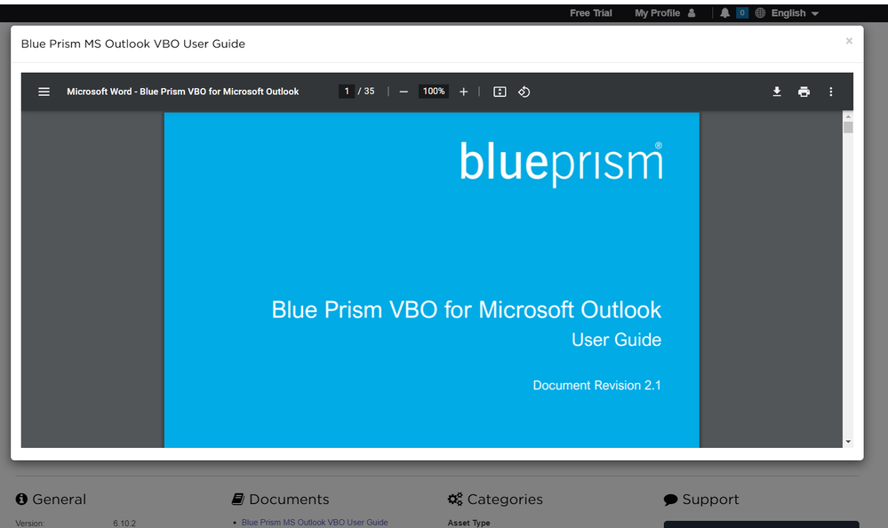

5) Also, Tried to download below but says "This content is blocked, Contact site owner", where can I get these documents?
BluePrism MS Outlook VBO User Guide
Blueprism PDF Asset User guide
Appreciate all inputs and help.

@MarilynGagarin,
Those user guides are displayed as PDFs in a dynamic pop-up window (this not a new window or tab). Do you not see this when you click the links? You do have to be logged into the DX to see these.

I made sure I am logged in to DX but still same issue/error and not able to get the Documentation/Guides. I open case DX folks  and provided me a copy while they're figuring out the cause.

I wonder if your browser has any sort of Javascript execution limitations? That could be part of the issue. You could always try accessing the DX from a personal computer/laptop/iPad and see if you're able to view the documents.

1) Yes, I was able to view documents by accessing it from my personal laptop. Thank you!

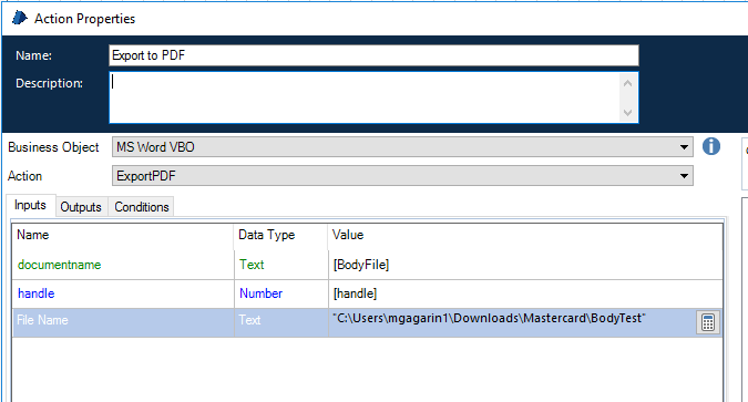

2) I was able to use Read from MSG action, save it to Word doc but when I used ExportPDF action I am getting error, see below.
  Note: under input Filename I tried leaving this blank, also putting filename extension .pdf but still getting this error bad filename.
  Note: [BodyFile] is the word doc named BodyTest.doc where the body from .msgfile was saved.
Can you advice and tell me what am I missing here? Appreciate  your help

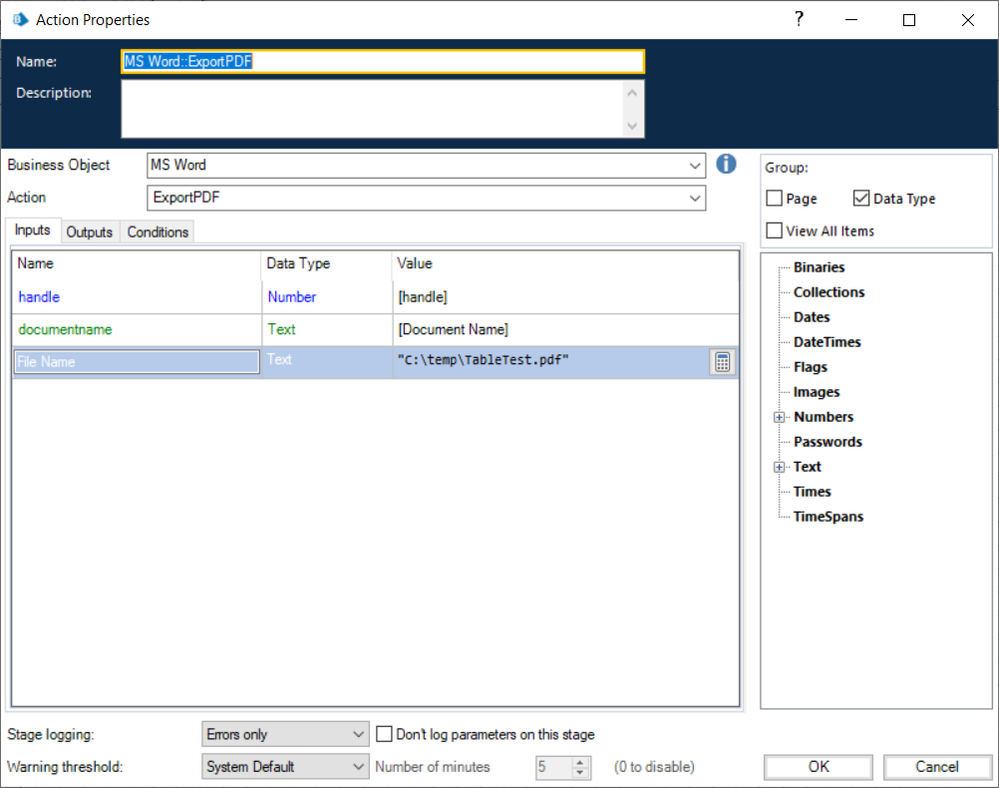

@MarilynGagarin,
You still have the document opened in the Word VBO when you attempt to export it to PDF, correct? If you've closed the DOCX before exporting it that would cause a problem. Also, on the filename, you do need to include the .pdf extension.
Here's a screenshot of the properties on my test:
In this case [handle] is of course the numeric handle of the Word instance started with the call the Create Instance. [Document Name] is the value (i.e. TableTest.docx) that was returned to me from a call to Open Document. In your case, you should have gotten that name as output from a call to Save As I imagine (when you first saved the DOCX to file).

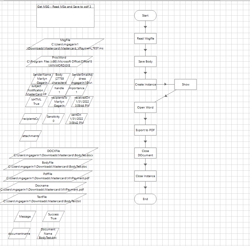

A. Choosing alternative#1: Below page worked  but having some issues:
1) when MSG is saved to WORD .doc file, the output format on tables is not same as when you manually print it to PDF, see screen shots below
Note:The output (body) from ReadMSG is saved to Text file named BodyTest.doc or BodyTest.docx, is this how you save it to WORD Doc?
2) when MSG is saved  to WORD .docx file, the word file cant be open and corrupted
Note: not sure if this will matter if file is save to .doc not .docx as long as the pdf output format is same as in .msg file format especially on the tables.
B. Choosing alternative#2: Is this same like doing it manually? Like opened the .msg file, then use send key Ctrl-P or spy on File, then spy on Print box, send key ENTER, enter pdf filename.  How will I open/load msg, is there an action/page that does this in MS Outlook VBO -Extended? Once I will know that then I can do the rest. Can you give example or prototype

Hi @MarilynGagarin,
After thinking about this a bit more, I'm surprised #1 worked at all. When I was thinking about the body of the email I was thinking about plain text, but as you've shown it's really HTML/RTF. What did you actually do in the Save Body step?
For option 2 there's no standard VBO for automating the UI of Outlook and I think I know why now. I tried to build a quick example app model for you, but it seems the UI of Outlook is not easily spied. ☹ So while the tables aren't quite formatted the exact same way in your #1 solution, I think you may have to accept it to get what you want.
I did come across some articles online that talk about saving the original email to either the HTML or MHT (also HTML) format instead of MSG. Those files can then be opened directly with Word and exported to PDF. Do you have flexibility in what format your messages are saved to file in?
