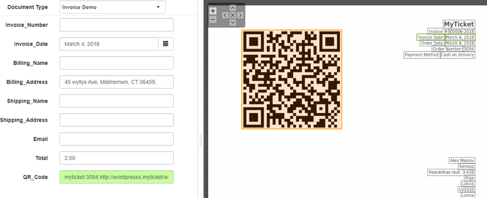

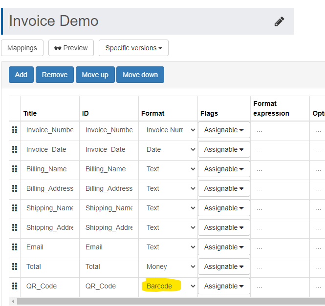

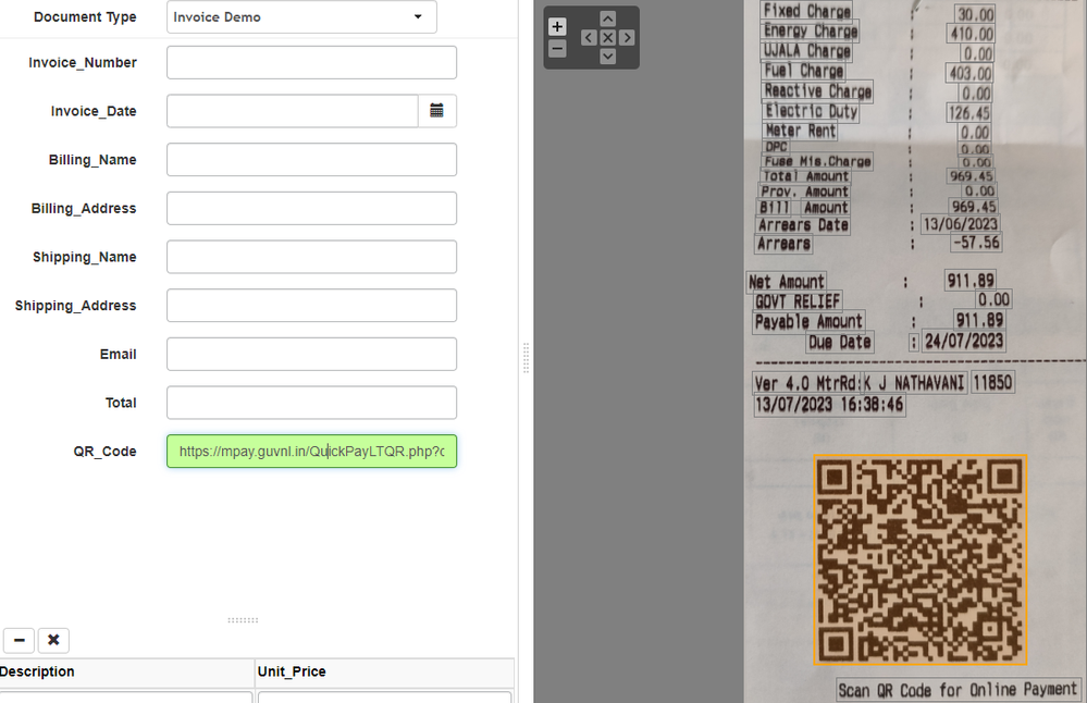

Blue Prism Decipher 2.2 has the capability to extract information from QR codes found in PDFs and images, utilizing the Barcode format in the Document Field Definition setup.
Scanned Image Result:
Digital format PDF result:
