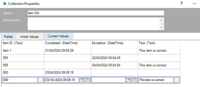

My collection
My filter

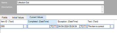

My output

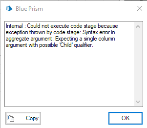

04-04-24 04:05 PM
Thank you Emerson. I've set that up already but I see this when I run the filter:

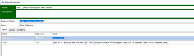

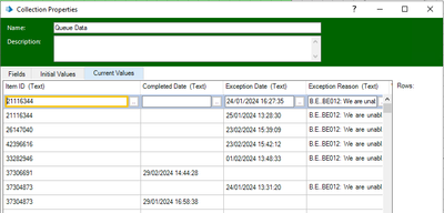

04-04-24 04:51 PM
[Queue Data] is the original collection containing duplicates.
[Unique Item ID's.Item ID] is the collection containing the unique item ID's
04-04-24 11:47 PM
Fixed some issues with the formatting. It kind of works but only if there are duplicate item ID's, if the item id isn't duplicated I'm not seeing any results
