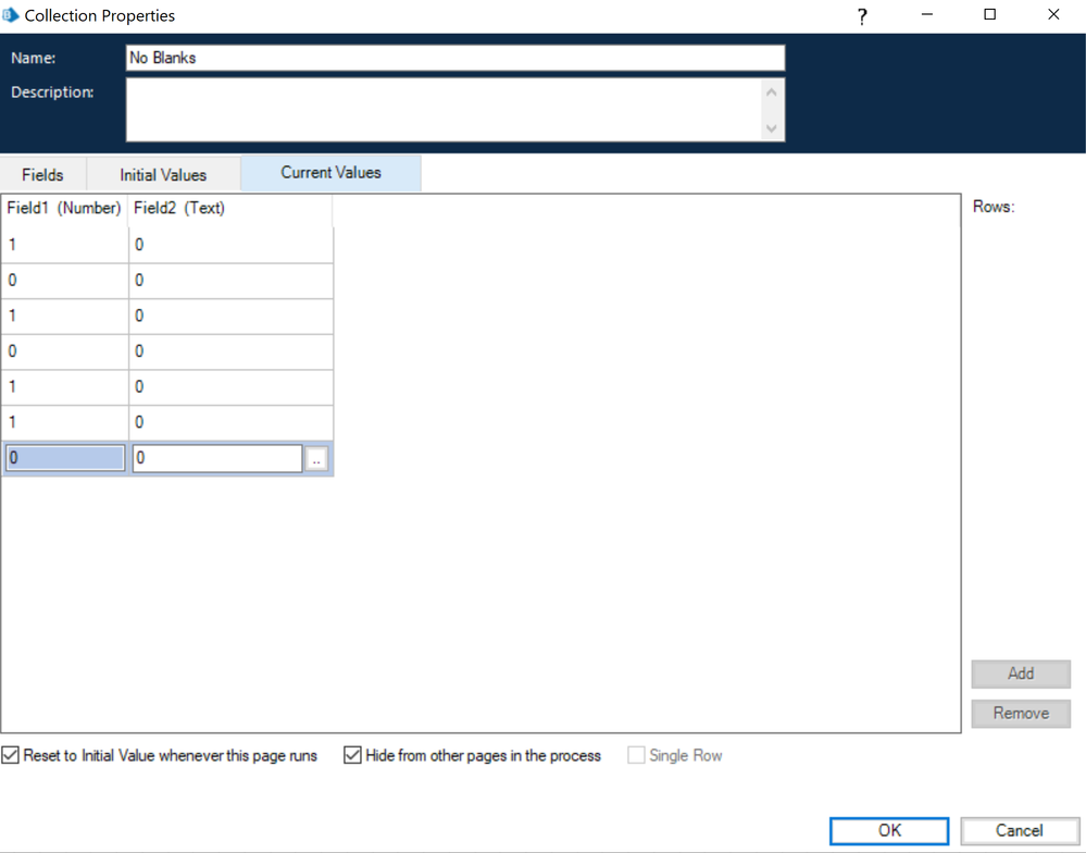

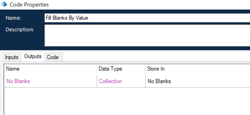

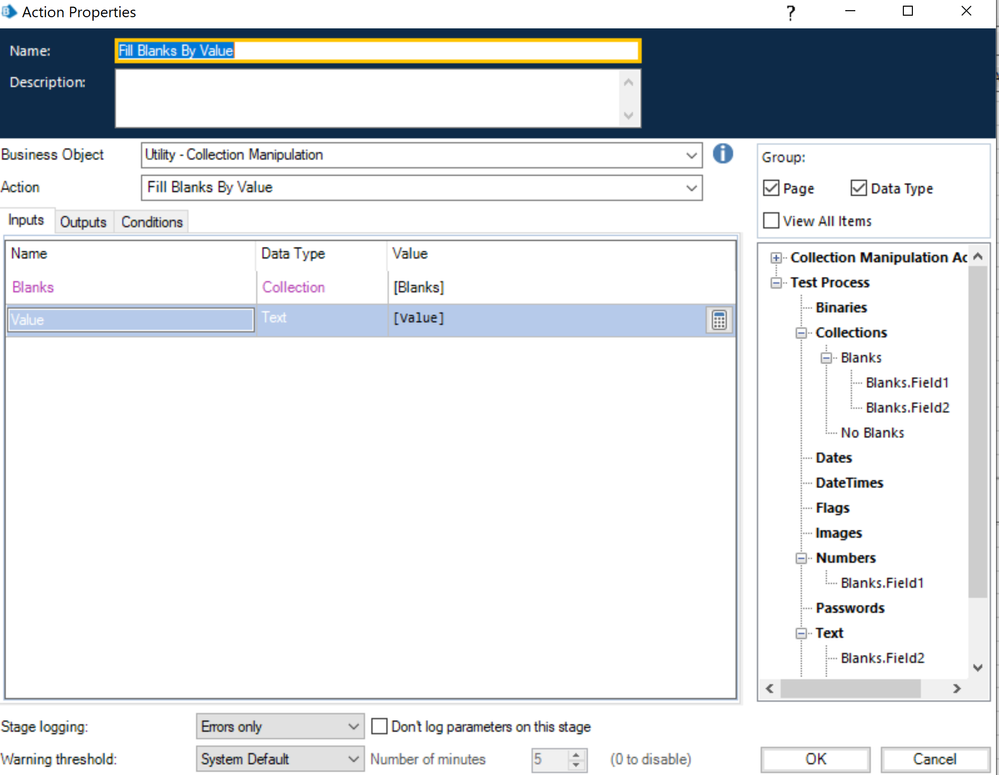

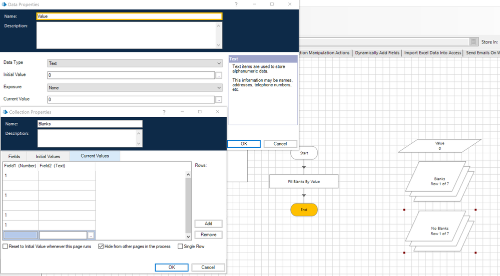

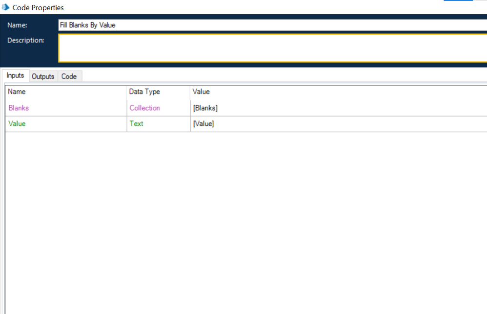

I tested the same on a collection having both a Text and Number column as well as with a collection having only Number column or Text column. In all these cases it is working. Please find the below screenshot for your reference:
Inputs:
Outputs:
Code:

Parameters:
Cross check once from your end if you are using the same code and parameters along with the type of inputs.
