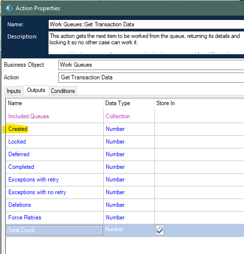

If you want to do it manually. then you can do this from the control room itself by filtering items by Creation Date and force retry.

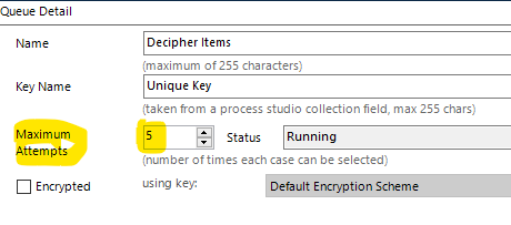

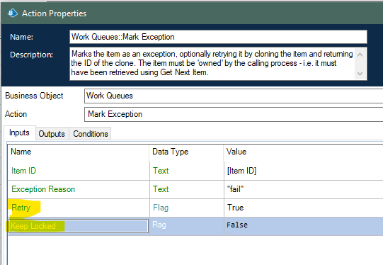

If you are looking for an automated solution I would suggest building a mechanism inside your process itself to handle such scenarios. You can use retry loops inside the process itself to avoid manual force retry from the control room level.
Below are some automated options that you can integrate into your design itself.
