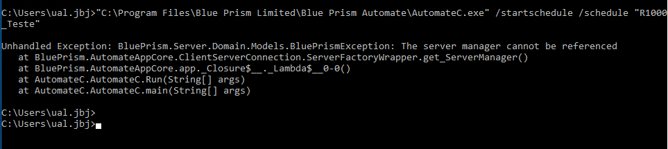

C:\Users\ual.jbj>"C:\Program Files\Blue Prism Limited\Blue Prism Automate\AutomateC.exe" /startschedule /schedule "R1000_Teste"
Unhandled Exception: BluePrism.Server.Domain.Models.BluePrismException: The server manager cannot be referenced
at BluePrism.AutomateAppCore.ClientServerConnection.ServerFactoryWrapper.get_ServerManager()
at BluePrism.AutomateAppCore.app._Closure$__._Lambda$__0-0()
at AutomateC.AutomateC.Run(String[] args)
at AutomateC.AutomateC.main(String[] args)

I'm confused about having to enter additional data such as my username, password, bank login or DB domain...

If you're using Active Directory and not passing /username and /password switches, you should be using the '/sso' switch instead. This instructs Blue Prism to authenticate the command based on the current user's credentials in a Single Sign-on (SSO) configuration.

Jrwork
Level 7
@steven.boggs  Thank you very much for your support, I have progressed on the topic and I am executing the robots between other servers.
