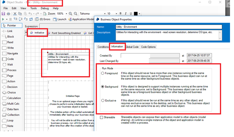

Manas, this means that either one or both of the processes which you intend to run at the same time use business object(s) which doesn't have or isn't able to have the correct run modes. The business object(s) which are used in the processes must be either "Foreground" or "Background" run mode, though if it's "Foreground" it means that both processes can't use the same business object(s). If you want to be able to run the processes at the same time all business objects you need to make the necessary changes in all the business objects which the processes uses. I've provided a screenshot where you can find the run mode of a business object and change it
/Joakim

Just to echo Joakim, all Run Modes of all processes need to be in agreement.
1 background running + n new background = OK
1 background running + 1 new foreground = OK
1 foreground running + n new background = OK
1 foreground running + 1 new foreground = Not OK
1 foreground running + 1 new exclusive = Not OK
1 exclusive running + anything = Not OK
