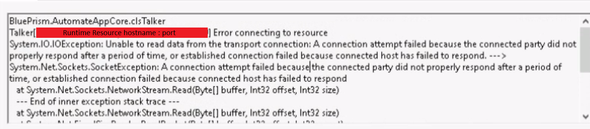

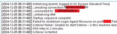

*Logging in the resource, and checking on the runtime resource window, when it gets disconnected it shows this error "An SSL/TLS authentication error occurred. Please contact your administrator for assistance", and also, the automatic connections to the both app servers shows like this, AppServerB shows the full hostname and with IP but when it gets connected to AppServerA it just shows Unknown then the IP:
Checking on the event logs of server:

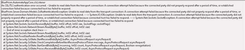

checking event logs of runtime resource:
"BluePrism.AutomateAppCore.clsListener
An SSL/TLS authentication error occurred. - Unable to read data from the transport connection: A connection attempt failed because the connected party did not properly respond after a period of time, or established connection failed because connected host has failed to respond.
BluePrism.Server.Domain.Models.SslAuthenticationException: Unable to read data from the transport connection: A connection attempt failed because the connected party did not properly respond after a period of time, or established connection failed because connected host has failed to respond. ---> System.IO.IOException: Unable to read data from the transport connection: A connection attempt failed because the connected party did not properly respond after a period of time, or established connection failed because connected host has failed to respond. ---> System.Net.Sockets.SocketException: A connection attempt failed because the connected party did not properly respond after a period of time, or established connection failed because connected host has failed to respond"

Thanks everyone for the help.
After checking the infra again, tracing back, it has come to our attention that the loopback DNS entry for one of the AppServers that we have is missing, its the cause of the disconnection. It checks out with the initial screenshots I've provided that its getting New Connection from Unknown {IP Address here}..
