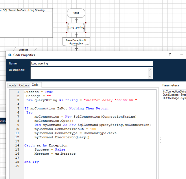

​Hi Blueprism team I have tried to set the timeout in blueprism to 400 seconds. It was done inside the object Data - sql server connection to sql database. see attached file
Question why does it not work.?
greetings Kristian

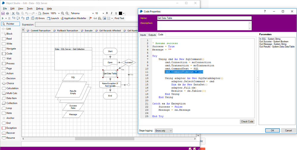

I think the Blue Prism support article is a bit misleading; that code will only change the timeout of the "waitfor delay" query, it won't affect any queries afterwards because the timeout is specific to the SqlCommand object.
Assuming you're using the Get Collection action, you'll want to add a line to the code in the Get Data Table stage: cmd.CommandTimeout = 120 (however many seconds you need)

Hello blueprism
The issue is that it timeout after 30 seconds and not 400 seconds.
I have the connection​ string:
database="PSP_Prod_PSLiv";data source="PENFLXIPINS002\I02";Trusted_Connection=Yes
errormessage from blueprism:
Execution timeout has expired. The timeout period expired before the operation was performed or the server did not respond.
The code is from : https://portal.blueprism.com/customer-support/support-center#/path/Operational-Support/Performance/Database-Management/1360595772/Why-do-I-get-Execution-Timeout-Expired-The-timeout-period-elapsed-prio...
But blueprism timeout after 30 seconds.?
In sql management studio it can execute the query in 50 seconds.
greetings
Kristian

thanks its working
