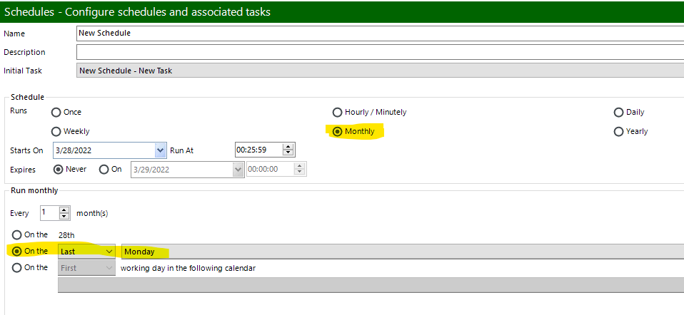

How can we schedule a bot at last week 1st day in month?

Hello Hari,
Blue prism does provide a way for the same requirement as you have mentioned.
Check below screenshot and try if that works for you.
