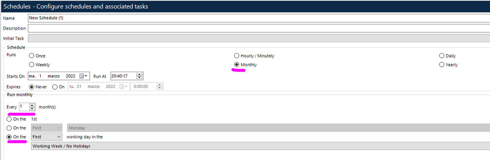

For create a new Schedule go to the Control Room and then, on the Schedules section, right clic and "New Schedule". For more info of this part, here you have a quick link for the documentation: Configure scheduler elements
For the first one:
    - Select runs "Monthly"
    - Every 1 month
    - And select the last option "On the" "First" working day in the "Working Week / No Holidays"

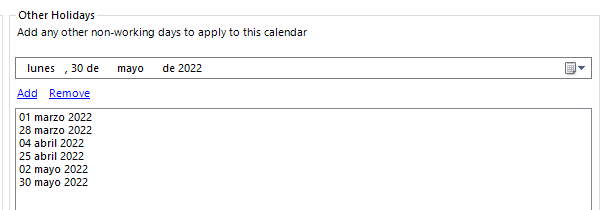

Create a new Calendar in the System Tab. In this new Calendar, add the days that you want to run as a holidays days, for example, like this:

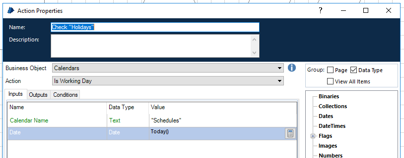

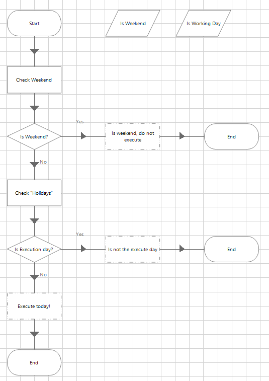

Now... schedule this process daily (Runs daily, every 1 day). And add at the begging of the process this validation:

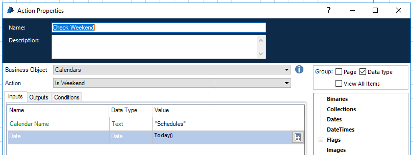

In the two action stages i use the "Calendar" object to access the calendar that we configured above.
The idea of that is to check if Today() is not weekend and is a "holiday". If this is true, you may execute the process, if not, exit directly.
